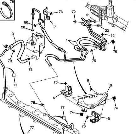

x 3565
Re: Help! Steering has gone light!
It shows as conventional power steering. The pump sits in / on the tank and is belt driven.
Xsara pump
Xsara pump
