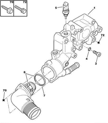

Ok after doing some delving I find I need to replace the temp sensor which sends the signal to the dash.
I have a 2002 C3 LX
Anyone have the part number for this sensor and more importantly is there a picture showing exactly where it is for this model?

It could be useful to post your ViN here. That way, those with access to the Citroen Service site can look up your vehicle and get you the correct part details (as there could be several possible options).

I think I have located it - but there was a 2-way sensor introduced to replace the 3-way one on the TU3JP engine from a certain date, so I will need your VIN to determine the correct part number from your RPO.

Ok, so you need the blue water temperature sensor (12x150-65 3-Way), not the green one. The part number is: 1338 A6, it is currently £43.09 inc. VAT from Citroen. (part 5 in the diagram I listed previously).
