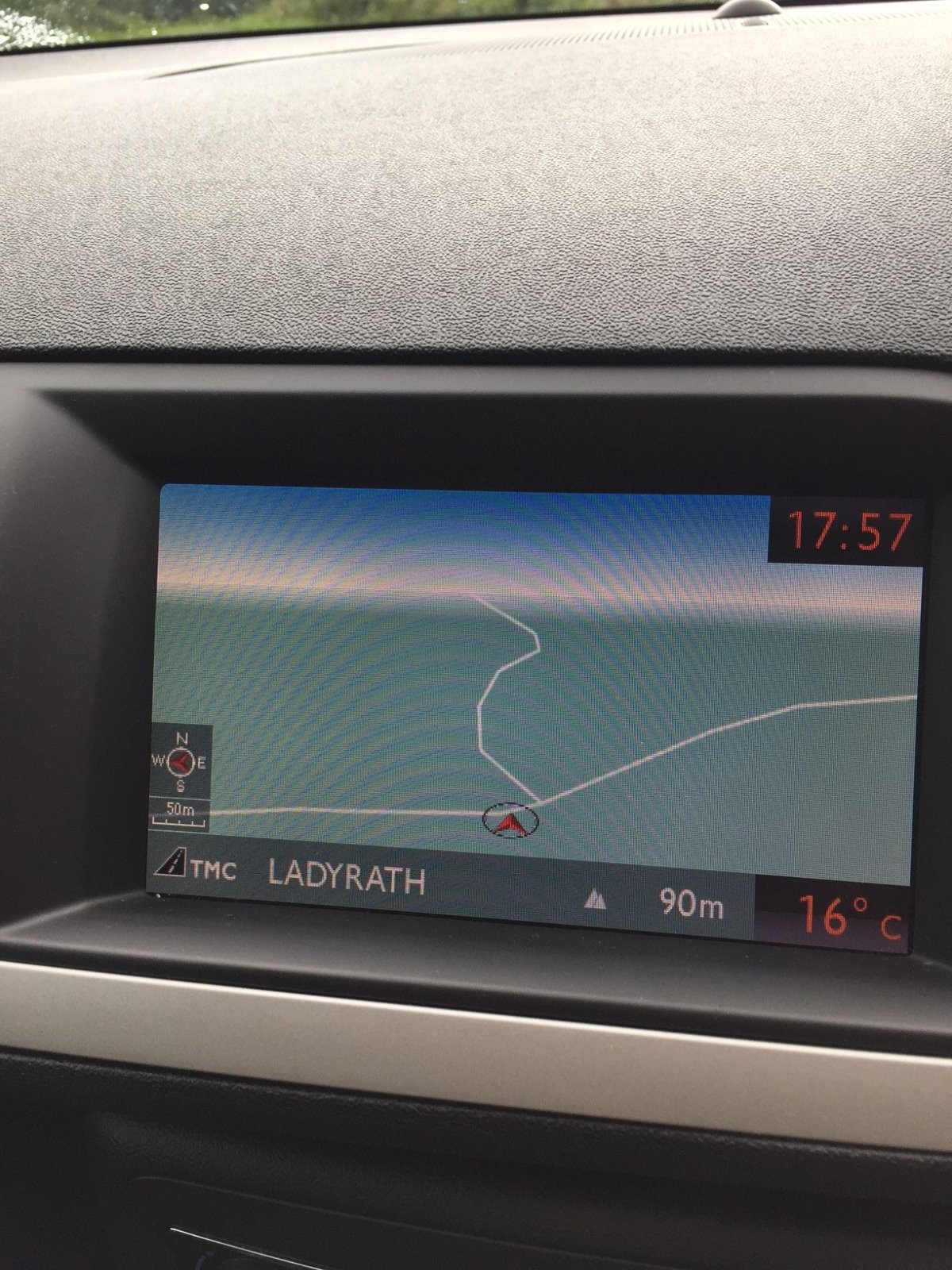

Re: SAT Nav Offset
Hi Guys,
well done the full reset and followed it to the letter. Regretfully the fault remains. Please see attached photo.....I'm actually parked at the junction, however map shows I'm just short of it, I even waited a minute to see if it would catch up but no...... 10 Sat's showing "good" localisation. Guess I'm stuck with it?

Re: SAT Nav Offset
I'm running out of suggestions Kev; the following is an extract from the Government's GPS info page, but there could be other reasons like the calibration of the unit itself. These are pretty much set at factory and I wouldn't want to suggest changing any settings (if possible) in the extended system menu.
If it was a large speed discrepancy between the GPS and the speedo, I would of suggested a faulty ABS speed sensor, but this won't account for the actual positioning. You don't live near any secret military bases do you?
You could try a system reset Kev:
I also wouldn't want to suggest the mapping software is corrupt, as you had the same issue on the older map versions and firmware.Many things can degrade GPS positioning accuracy. Common causes include:
- Start car, wait for system to load.
- Press and hold SETUP until system menu loads.
- Then a quick press on SETUP, let go and hold buttons 1,2 & 3 in together until the second menu appears.
- You should see HMI, SYSTEM & SETTINGS as the first 3 menu items.
- Select SETTINGS and from that menu, there should be a SYSTEM RESET (REBOOT) option about 5 items down.
- Hitting this will make it all go blank and it will reboot.
