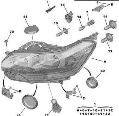

Yes, but on the C5 with halogen lights they are 55W H7s for the cornering lights also- which is why we were wondering why they didn't use the same fitting for both:xf1ref wrote: 09 Aug 2017, 14:23 In my opinion the corner lights have only 19W because if were bigger could blind the drivers from opposite direction, especially on mountain roads.
Here are both Halogen versions and both have the H7 55 Watt (Part 11) bulb for the Angular Lighting, no HP19 on halogen versions. The cornering lighting is only operated at speeds below 25 mph (approx 40 km/h), when the direction indicators are on / within a certain angle of rotation of the steering wheel). Going round the country here, it does a good job of lighting up the hedges on single track lanes at slowish speeds but not much in front given that they are nearly 90° to the main lights. But on the Halogen versions of the headlamps, having a 55W H7 in there would certainly increase the light output and range I would suspect!

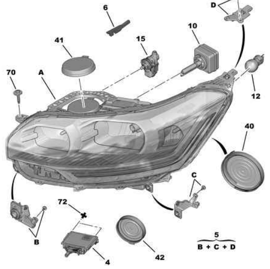

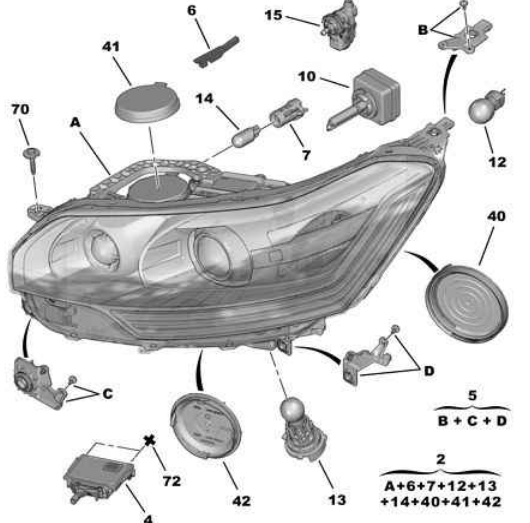

Here are the 2 Bi-Xenon Discharge Headlamp versions, which both have the PH19W Bulb (part 12):
For the eagle-eyed, you may have noticed that on the later Bi-Xenon lamp just above, there is no bulb shown for the DRL, nor for the housing next to the D1S bulb. So one assumes that this version contains the LED strip lights in place of the HP24W older DRL - and I have to assume some LED fitted next to the D1S bulb too - neither of which are listed as replaceable parts.
