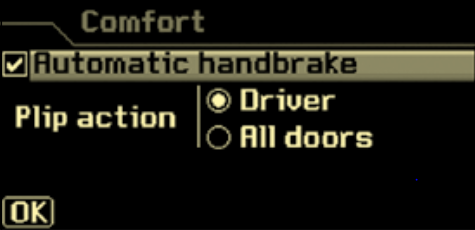

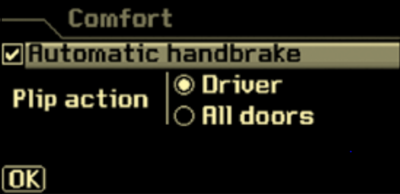

The bit regarding the other doors remaining locked is an option you can configure that determines whether just the driver's door opens when unlocking or all the doors. It is accessed from the car menu (Press in left hand wheel button), Vehicle Parameters, Comfort Option as here:
Might be worth checking to see what the setting is there first, but wouldn't account for the other anomalies.
With the car locked, then unlocking, the interior lights should come on straight away before opening the door - check to see if this is happening.
The first thing I did when i got the car was to configure it to open all doors.... it's very annoying going to the boot with an armfull of stuff and having to find the key agian.

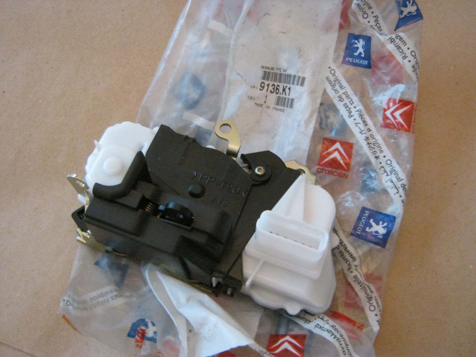

Is this the item I need? http://www.ebay.co.uk/itm/Citroen-C5-fr ... Swl5dZceWq
There appears to be a multi-way connector so that suggests that the door switches and possibly the lock solenoids are all internal to the unit?
Has anyone ever done this before? I'm struggling to find any guides :?

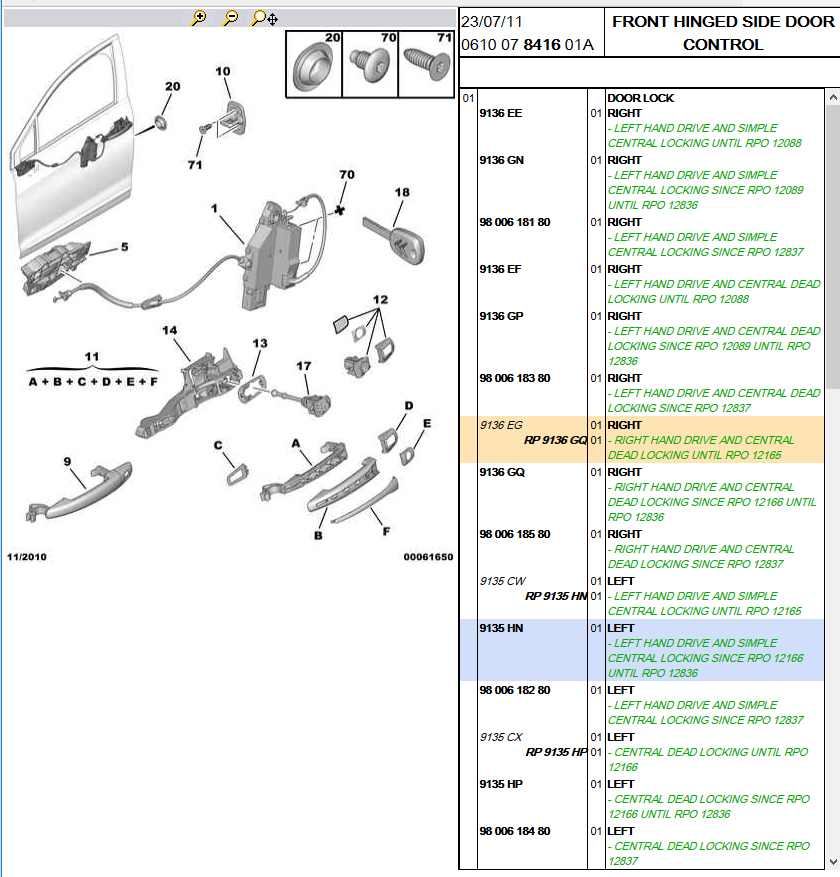

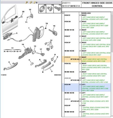

The correct part is very much RPO / year dependent. This shows overall options for an X7 with 138 engine - there's 3 possible choices !
Door lock options
Door lock options

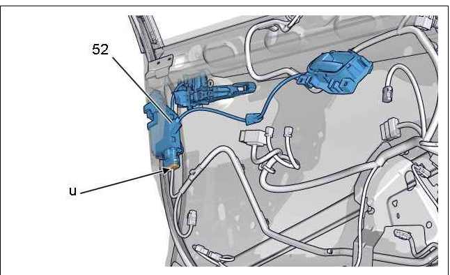

This is how everything fits in a left hand door -
Door lock fittings
Door lock fittings

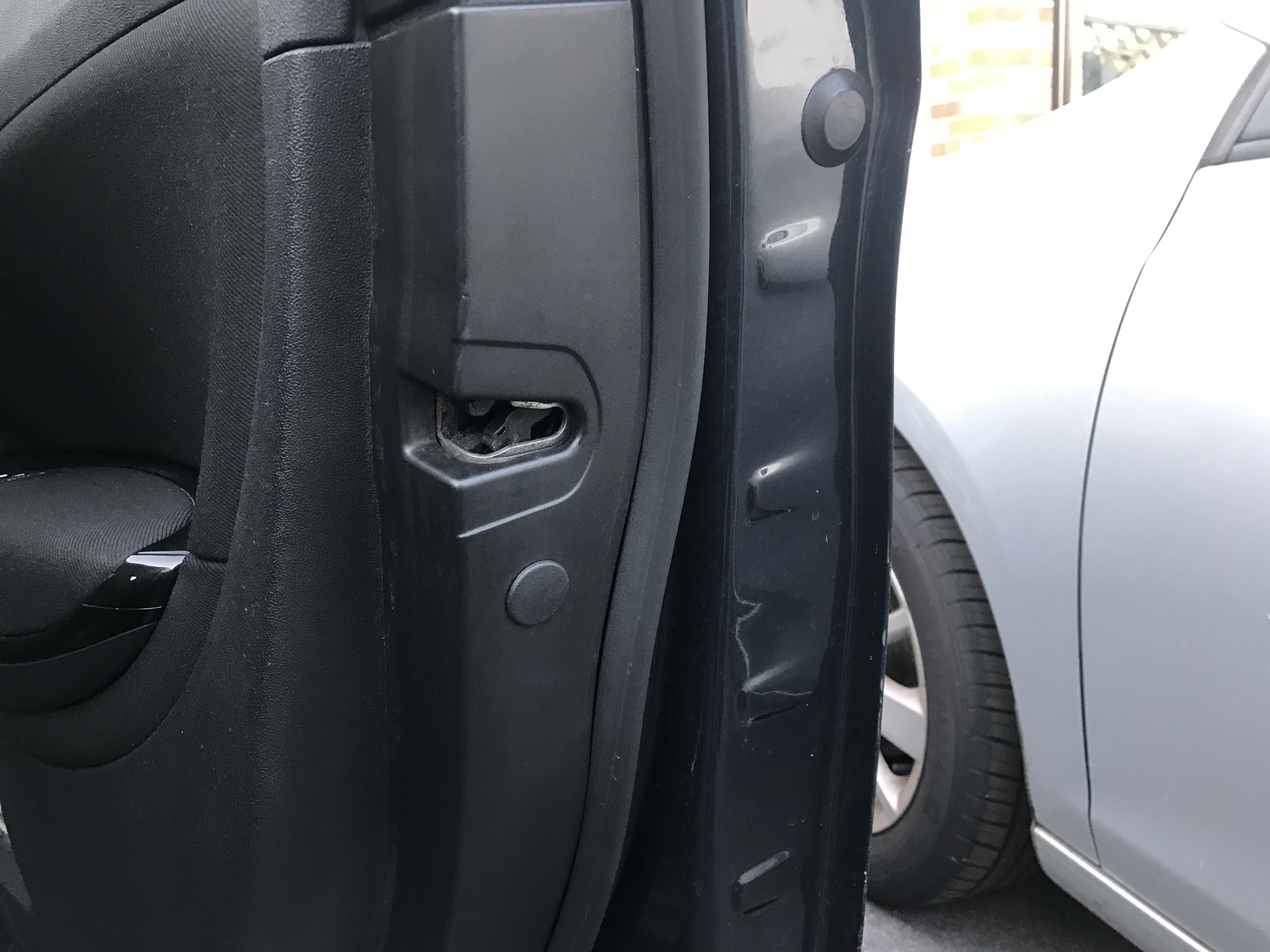

And this is how to get the lock out:
"Disengage the assembly : Lock (52) - Exterior opening handle caliper - Interior opening handle.
Release and disconnect : The connector (Lock (52) ) (at " u").
Remove the assembly : Lock (52) - Exterior opening handle caliper - Interior opening handle."

Thanks for that pic..... this isn’t going to be simple is it :lol:
Hmm, since I'll never find the right part maybe it's worth pulling the old one off and opening it up for a look. I'm guessing the switch is inside component '52'?

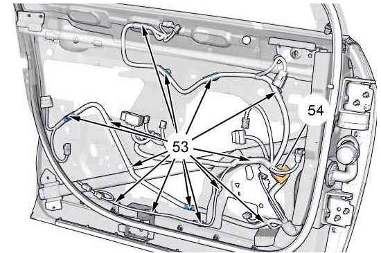

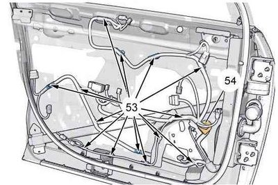

Looking at the door harness layout, the only wiring that goes to any of the three components in blue in the above picture is the the one at 'u'.
Here's the harness layout for a left hand door.
Harness layout
Harness layout

I think I'd start with making absolutely sure it's not a duff wire somewhere in the door wiring loom or where the cables pass from the door pillar to the door itself.

Elis, that part is not correct for your X7 - If it's the door LOCK, then you will need:
9136 EG (9800618580) for the right door control or 9135 CX (9800618480) for the left. They now have been replaced with the part numbers in brackets.
If it's part 5 - the hinged opening door control, then it's 9144 F6 (9144 G4) for the Right Hand module and part 9143 S7 (9143 T8) for the left hand one. Again replacement parts in brackets - to aid with sourcing a spare, but I would certainly double check the harness as Bobins suggests - especially near the door hinges, inside the wiring protection tubes. :)

Thanks for that, I assume it's the part with the switch in rather than the handle unit as the door always opens fine. Just to be clear I'm looking for part 9136 EG (9800618580) for the drivers side lock?
I'm guessing it's a door card off job... luckily I'm still fresh on that procedure from the speaker change :)
x 6963
Re: C5 Door Switch Location
That's the one Elis. £107.12 inc. VAT from Citroen - IF it is this that's the faulty part.

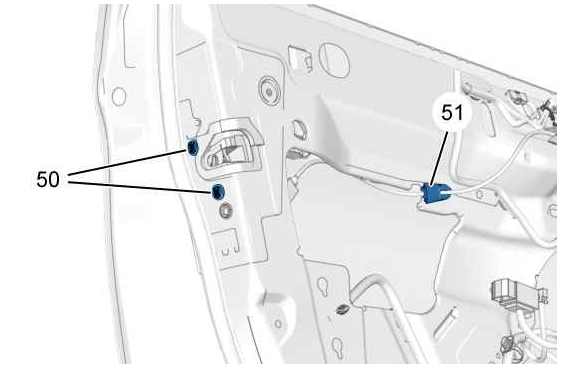

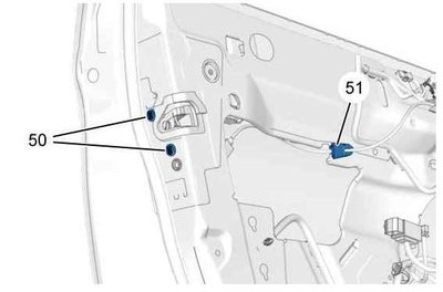

EDC5 wrote: 19 Sep 2017, 18:37
Yep, securing bolts under the trim (50)
Door lock bolts
Door lock bolts
