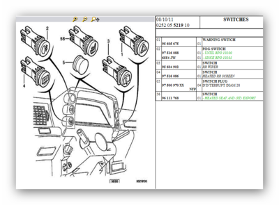

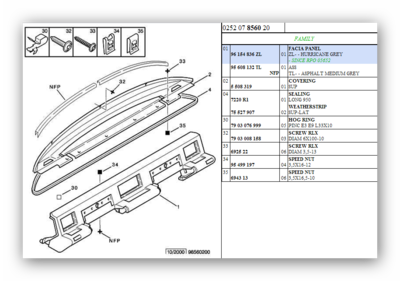

Re: C15 switches
Maybe these pictures will help.
van ordinaire
- (Donor 2017)
- Posts: 2537
- Joined: 23 Jun 2015, 14:45
- x 400
Re: C15 switches
I've pored over those piccies &, if anything, am more confused than ever.
the one of the instrument cluster does show it as a complete unit, but gives no clue as to how it's fitted - or removed; whereas Haynes spells out how you dismantle it, to remove it.
that one showing all the switch options (which C15 had heated seats????) does suggest they are fitted/removed from the front - but I think it must be just to show what they look like & their positions.
