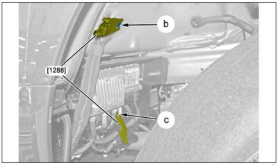

Re: e-booster
I would be very careful touching anything here - you need a special tool to discharge the thing before doing any work on it. It is behind the front wheel:
