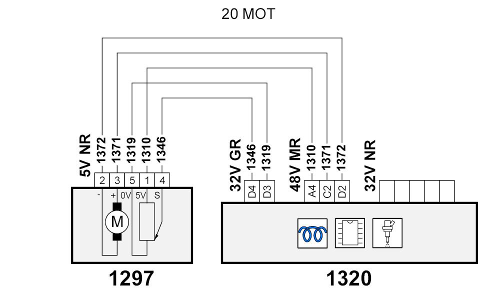

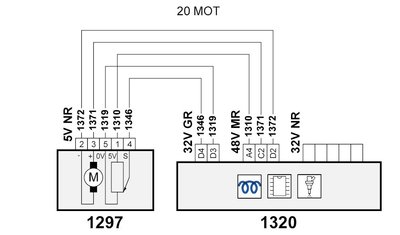

Couldn't find it on the Berlingo, but here is the one from a same age C4 Picasso:
1297 is the valve, 1320 the ECU. 32V GR on the ECU means the 32 pin grey plug, 48V MR a 48 pin brown plug. The pin locations should be numbered, and the wires will be numbered. Somewhere
On the EGR pin 2 and 3 are the power supply - you can't measure these directly as it uses a pulsed signal AFAIK. Pin 5 should be ground, and pin 1 5V. Pin 4 should vary between 0 and 5V depending on the position of the valve.
I think I would run an actuator test in the valve in situ with diagbox to see if you can hear it moving. If you can, then, check the signal on D4 of the grey plug to see if it is changing. If it's not moving then do a continuity check on the two power wires from the ECU to the valve.
