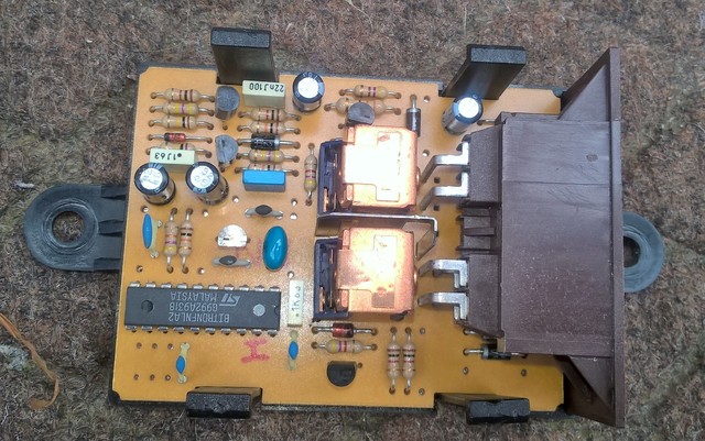

Finally got some time to have a look at the sinker. New rear sphere cylinder fitted and working, took an age to bleed there was that much air in the system. Offside windows don't work and electronics guy I know says the square copper things in the centre aren't working
If I can find some from another Citroen/Peugeot he can replace them. What cars are these fitted to or does anyone have any spare?
From this relay originally
EDC5

They look like the relays to me...
Are you planning on desoldering them and putting new ones on? In which case any 12v relay should do.

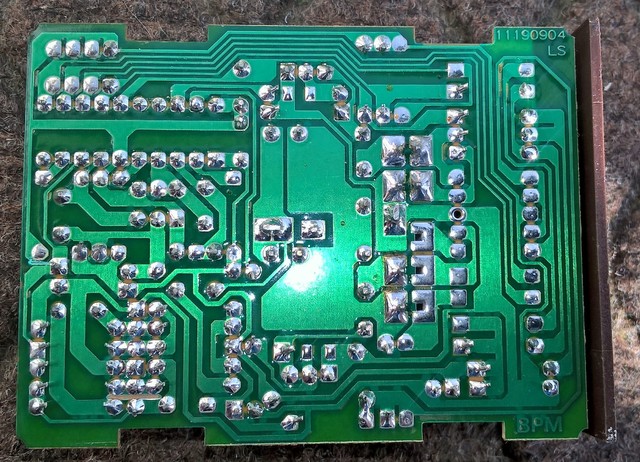

Eddie, Just to help nail these relays down, can you post a photo of the underside of the board, so we can see the relay solder contacts? Thanks.

Unread post by Eddie Nuff »
Here you go Chris, hope this means something to you

x 1746
Re: Xantia Window Relay
They look like a couple of 5-pin relays: two coil connections, plus one set of changeover contacts (3 more pins).They're not 'standard automotive' cube relays, but something else.
The fact that they're not operating doesn't mean the relays themselves are dud - it's actually unlikely, because relays themselves are extremely reliable. More likely the fault is elsewhere.
There are whole modules available on Ebay....just search for that Citroen 961....... number.
Sorry not to be of more help; just wanted to establish what sort of relays those were. Your second photo helped.
