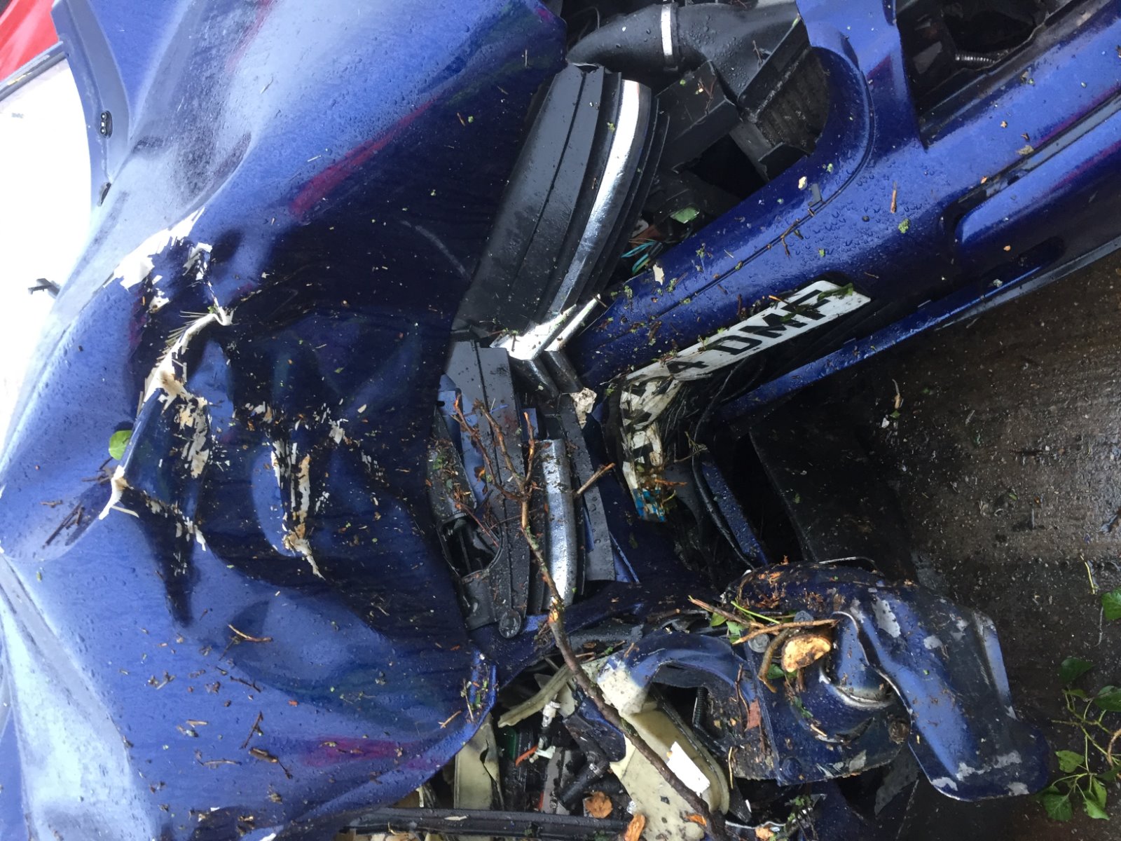

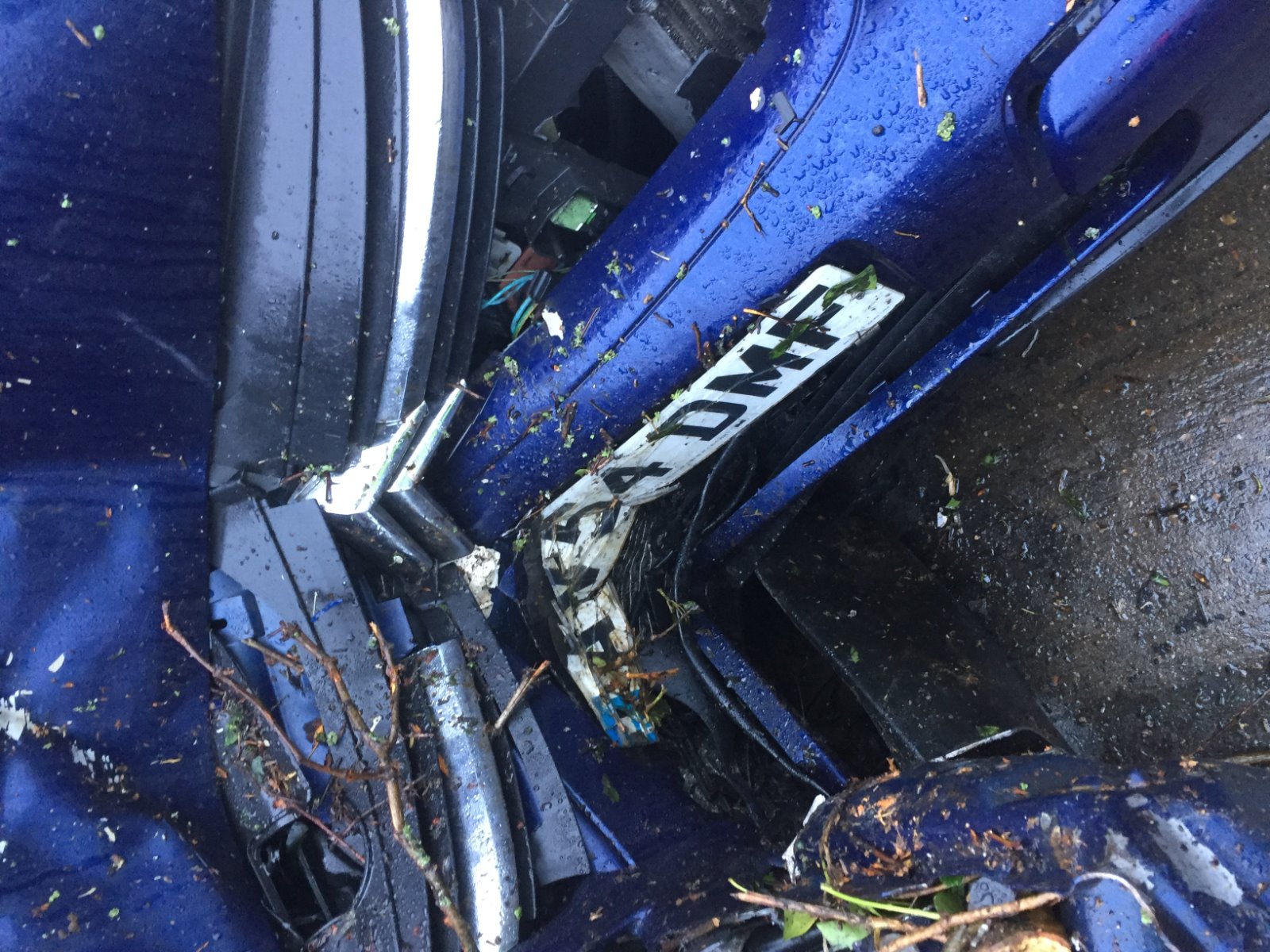

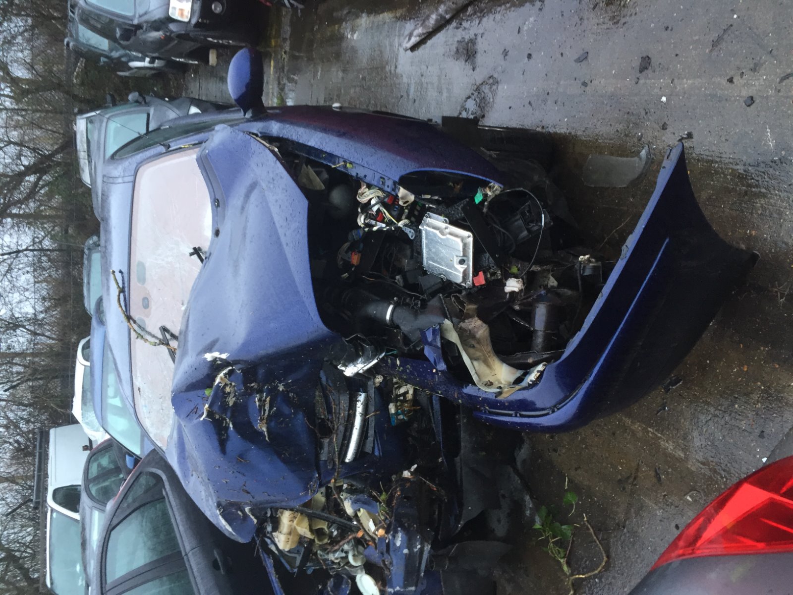

Fascinating account Howard. I still can't get over those impact pictures and it is hard to see that it is a C5 from the pics!
Sounds like you went through the wars on that one, but again, very pleased to hear you (and JT) are on the mend!
