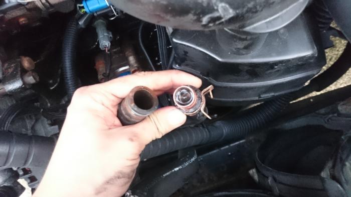

OK oil cooler test done. Took the coolant hoses off, piped them together (15mm copper pipe fit perfectly, thanks white exec!).
Ran for 15 minutes at idle, with a few bursts of revs from the throttle cable. Temp got to about 60 degrees on the dashboard thermostat.
Here's the results:
There's *no* oil coming from either coolant in/outlet:
There's *no* pressure in the coolant (dead water pump?)
The coolant I collected from the hoses is dirty, but not thick like what's in the the header tank (oil floats and all that).
Am I therefore pretty much definitely looking at head gasket?

Hmm, so the pic of the pipes under the comment about no pressure... was that with the engine running? If so then it does seem likely the water pump isn't pumping, and again that could lead to localised overheating/HG failure... :?
I'd suggest running it for a few miles with the cooling system bled up & cooler bypassed, and then dipping a strip of kitchen towel in the cooler stubs just to make sure. (if the HG is gone and water pump at fault the damage is done anyhow so a few more miles to prove it shouldn't hurt).
Be interesting to look at when the cambelt/pump were last done if possible & what the cost was, I have heard of cheap water pumps having plastic impellers that fall off the shaft.
