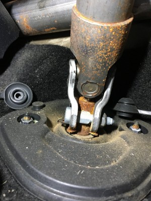

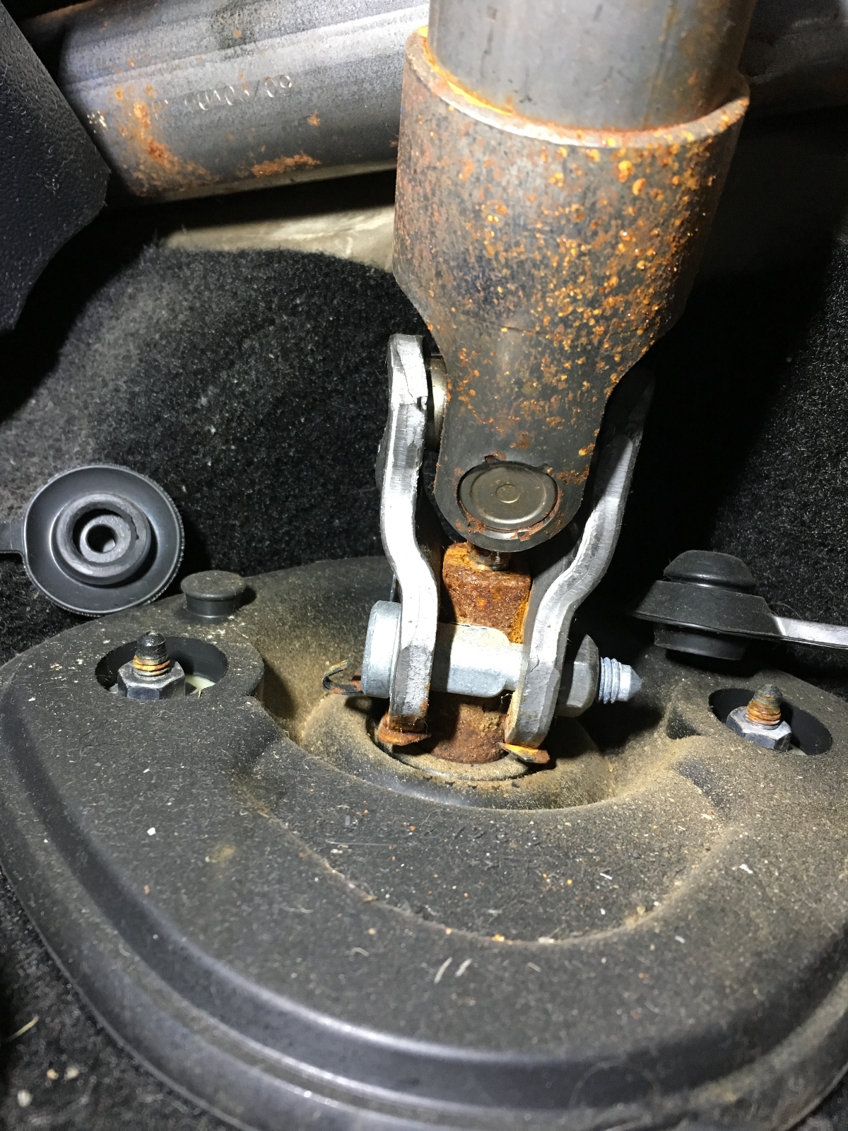

Just had a look at mines & its dry at the moment but the pinion shaft is quite rusty (picture attatched). How are these getting so rusty in the first place ?? wouldn't think a part located inside the car would rust like this. Ideally I want to stop it at the source.
Do we think if the column is taken off & the pinion wire brushed then grease packed in it should prevent the rust damaging the seal ?

Have you disconnected the steering column UJ and lifted up the plastic cover in your picture to see the nastiness below ? The pinion shaft is much longer than what's in your picture and the bit that fails is underneath that cover.
See my other thread for pictures of the pinion : https://www.frenchcarforum.co.uk/forum/ ... =3&t=57734
I think the reason they're all failing is - in part - due to the use of crap 'instarust' steel
