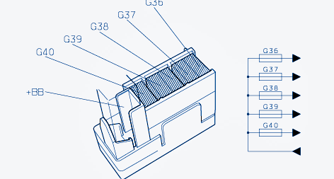

Ok, just to make things more confusing for people there are 2 sets of fuses with the same references it would seem with reference G36 to G40. One set in the passenger cabin fuse box (upper row on the BSI) found on a left hand drive vehicle under the driver's side compartment. The other in the engine compartment fuse box also labelled G36 to G40.
G37 in the upper row of the passenger compartment BSI fuse panel is for the heated front seats (if fitted). The G37 fuse in the engine bay is for the Daytime running lamps and the diagnostic socket.
Just to clarify DRLs: The first picture is for my car that has Xenons with the DRL on: This diagram shows the model with Halogen light bulbs (5 bulbs). Later nodels changed the DRL bulb shown (5) for the LED strip. So the DRL is the bulb shown in the top picture prior to 2013. So if you do not have this working - either your fuse is blown which might explain the OBD socket out - or your DRLs are not activated via the Car lighting menu or are not activated via the BSI. I doubt the latter is true because being Volvo country (
), I think they are required to be enabled by law in Scandinavian countries.

Now, just to make things even more confusing - I suspect there may be a mistake (not surprisingly) with the Citroen wiring diagram, because it seems that they have possibly got the pinout channel the wrong way round and mixed up pin 40 and fuse G37 and instead show Channel 37 and fuse G40! As per the handbook, and the table in my last post which is from the same wiring diagram, it should be Fuse G37 So you will probably have to do a visual check.
Note: I have spliced the picture together to save space, so BH09A on Channel 16 of the diagnostic port is as shown, but I think on the fuse box, channel 37 should be channel 40 and G40 should be G37!
Lastly, to confirm this, here is the fuse table from the manual which clearly states G37 is for the DRL and Diagnostic:

The G37 fuse for the DRL and OBD is the one under the bonnet - NOT the G37 that is also in the passenger compartment fusebox attached to the top row above the BSI, which contains the following fuses - they are not the same: (Click to zoom).

The bottom picture shows the TWO fuse panels for the passenger compartment - there are no more!
- bottom row (just out of view) and the top row - which is NOT the G37 for the OBD. See my last picture for these top row fuse diagrams.
- x 6945
Re: OBD2 problem on C5 2009, missing 12v
Have a check - are you sure you have located G37 in the under-engine fuse box - according to the diagrams it should be inside a plastic clip - I'll see if I can dig it out..... here it is
