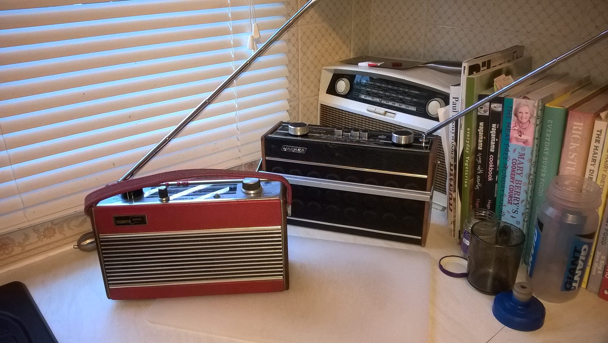

I can cope rather better with old-school electronics... Yesterday I successfully fixed the little Roberts wireless I got from NVCF on Sunday
- Posts: 55143
- x 8418
Re: Citrojim's Activa, 1.9TD, 207 and Bike Tales
The two transistor wirelesses obtained from NVCF at the weekend and both now fully functional
A Roberts R505 and a Hacker Aviemore...
Possibly two of the best small portables ever made... The Pug 205s of the wireless world
The valve wireless behind them is a Bush VHF80 and again an NVCF find a few years back. It still does most sterling service in the kitchen

My God, I recognise the Hacker as one my grandfather had in the early to mid eighties
I loved the way it looked and how solidly made it felt to small hands. The Roberts looks similar to one that a member of staff at school kept in the back of her Moggy 1000 about 10 years on...
