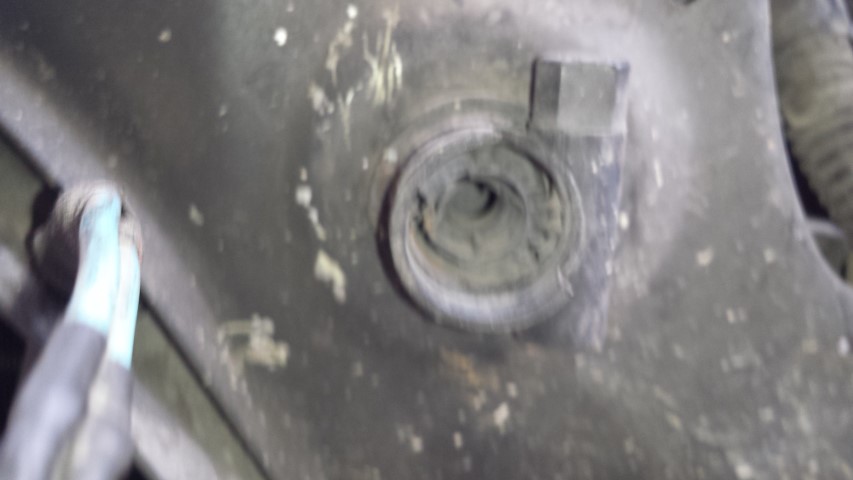

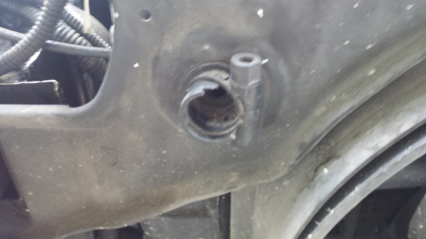

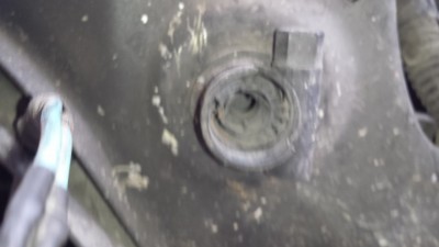

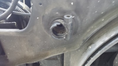

I'm miles from anywhere and have just started to restore a neglected ZX. The headlights seemed wonky so they are amongst the first things stripped off. It seems they should have 3 fixing points.
On each side 2 are OK but both the 'connectors' nearest the grill seem damaged - see photos.
Can anyone please tell me, or better yet show me, what these should really consist of - and is it's possible to get replacements?
The correct page from Citroen service would also be a great help. I'm afraid I can't access their information as I'm in the far North of Thailand.

Yes, those are the levelling adjusters from what I recall and were damaged on our ZX as well. Sadly I'm not sure what other vehicles may have suitable replacements or if they're available new at all because we basically glued the remains together and did without load compensation/levelling adjustment.

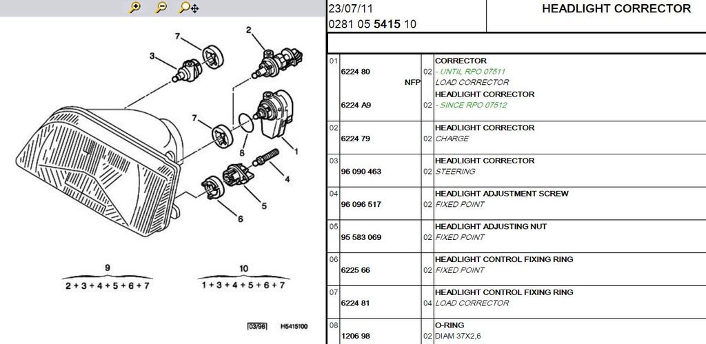

That looks like a plastic worm and cog adjustment, which has split.
Parts shows as still available. Check your RP number to make sure.

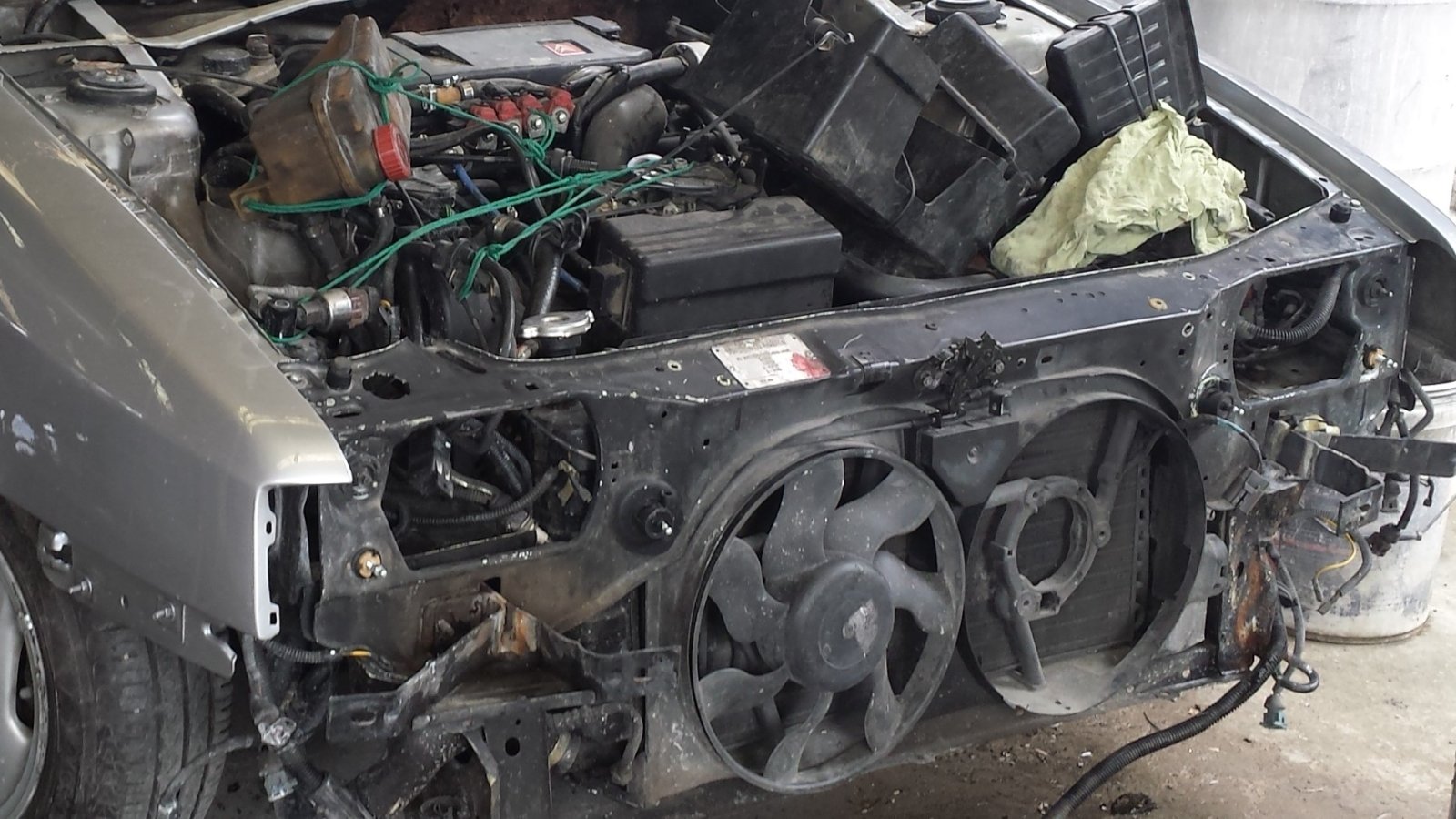

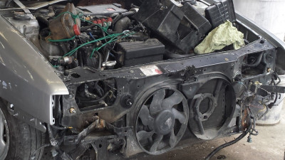

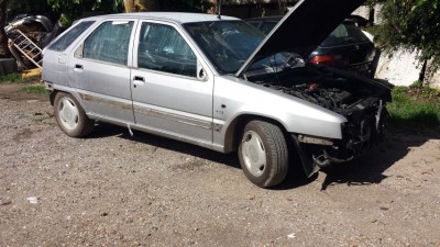

I'm not really a blogger, but here are a few photos, couple show the car as I first saw it, it then had engine and transmission work done and the lpg tank moved from the 'boot' to the spare wheel location.
First photo shows the initial strip down now it's moved to the body/paint shop. The Rochdale, sadly, remains in the UK - but is still going strong. All others are good fortunately.
Using the info from the parts list I have tracked down a supplier. I'll check it out with my mechanic and let you know how we get on.

I sourced a complete set of headlight adjusters for both left & right sides from China, where I learned that sales of the Kufang far outweighed those from Citroen and production continued for years after it ceased in Europe.
Those Chinese know a good thing when they see one!
They are fine quality and a third of the UK price - now my lights line up correctly!
A Milestone on the road to resurrection.

We have now got to the first coat in the re-finish which gives me a moment to show the Chinese headlight adjusters fitted. Easy job and now all the front end aligns correctly!
