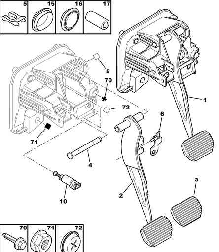

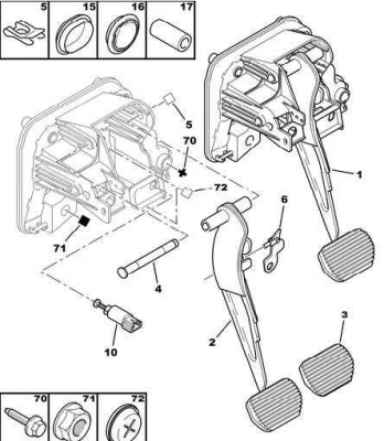

Re: AM6 auto tranny not going into Neutral State when stopped
This is the Toe Board Assembly showing the brake switch - number 10 and is part number 4534 65
C5 II Toe Board Assembly
Posts: 14291
x 3301
It is possible that that switch is actually TWO switches in one housing. My C5 Mk1 now has cruise control, but I had to check the brake pedal assembly for the relevant switches. One of the options was for two independent switches (each with a pair of wires), the other was for a single switch, but with four wires going into it. Mine had the latter option.
