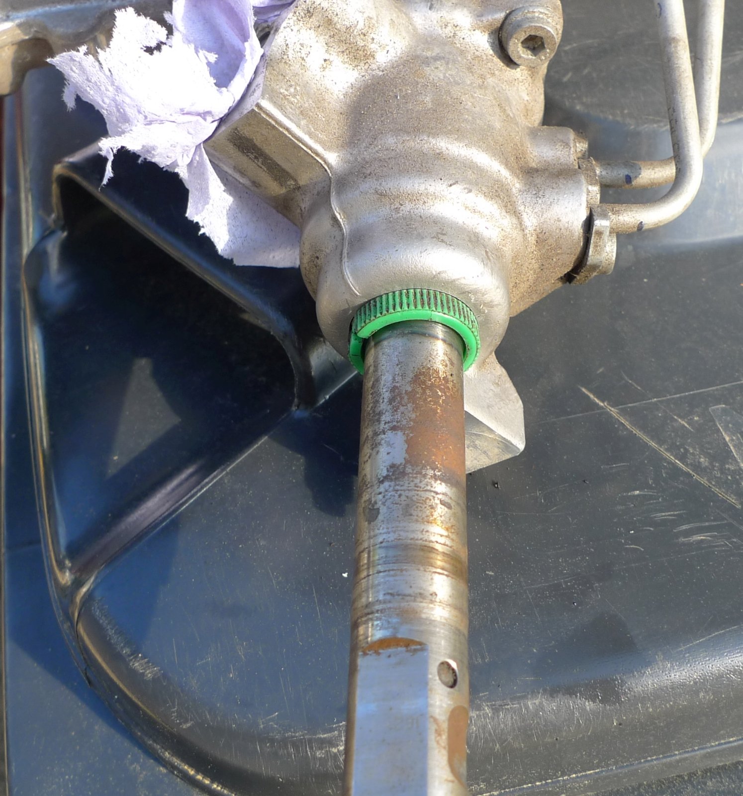

I've fitted a very low mileage used steering rack to my C5 this afternoon. It was a genuine Citroen one manufactured within the last two years and came off a car that had only done a few thousand miles since fitting. The main difference with the rack is that it's been modified by Citroen to combat the rusting pinion shaft issue :shock: :)
They have really gone to town and must have spent ages in the R+D department and spent an absolute fortune to completely overhaul the design of the pinion shaft in order to stop the rusting problem. Or maybe not :lol:

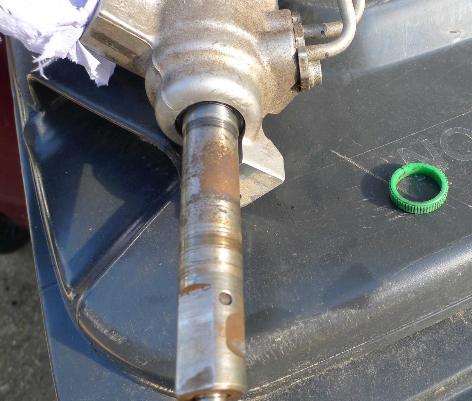

That green ring in the picture - well that's it !!

It fits tight into the small recess above the seal and wedges between the body and shaft. I tapped it home after I took the photo below.

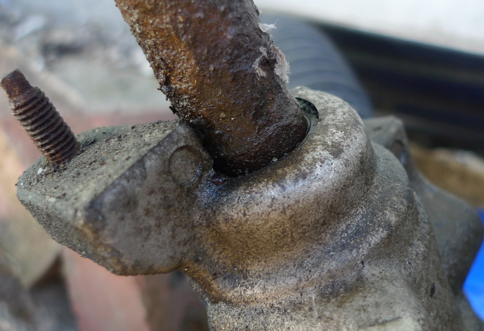

Have to admit though - it'd kept the shaft lovely and clean where it sits :) I've smothered the whole area in a protective wax before I fitted it to the car just to try and delay the inevitable.

I don't know when the modified racks were first introduced, but it's fairly easy to check the condition of your pinion and seals by following the procedure above for disconnecting the steering column in the footwell. You might need a camera or mirror and torch to see the seals (or eyes on stalks :-D ), but it'd be a good close up view of what state it's in.

I recently greased the pinion shaft on mum's C5 and found the green ring had migrated all the way up into the rubber floor bung.
Might have to put it back into the top of the pinion turret.
Thinking about it, when I greased my X7 the green ring was also not in the top of the pinon turret either!
