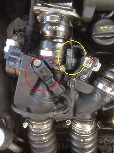

Hello everyone,
Today I had my car plugged in and it came up with the fault code: P0238 Boost pressure sensor (Open circuit/positive short).
Does anyone know where I can find the boost pressure sensor? I have took a photo of where I think it might be but I'm not sure which 1 it is or if its somewhere else?
Peugeot 307 2005 1.6Hdi
Thanks in advance

It's possibly the one circled in red - might be part no 1920CZ - if you post up the VIN I can confirm the part no; you can then look it up on e-bay or similar to see if it looks right (which I think it does: see this one)

Ok thanks Rich, the VIN is VF3**************[VIN obfuscated, can be read by forum staff] :)

RichardW wrote:It's possibly the one circled in red - might be part no 1920CZ - if you post up the VIN I can confirm the part no; you can then look it up on e-bay or similar to see if it looks right (which I think it does: see this one)
Did you get my last message Rich?

1920CZ it is

RichardW wrote:1920CZ it is
When I click on the eBay link you sent me, it says its a MAP Sensor/Manifold Pressure Sensor, is that the same as a boost sensor? Thanks

Yes. There are others on e-bay and elsewhere, this was just the first one that came up

Thanks Rich, will order one :)
