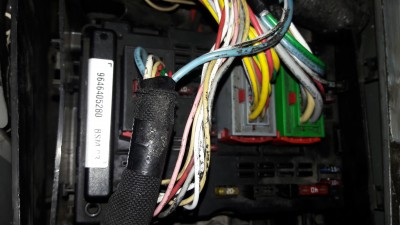

Also I believe that the BSM has been changed (by the Citroen specialist I went to see some time back) as the fuses positions don't match the table of fuse in the owner's handbook

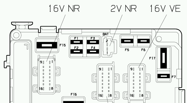

Ok, so your car has the ADC2 immobiliser, which on your petrol car locks the engine ECU as opposed to the Diesel ADC1 system that locks the diesel pump solenoid valve.
Check the following fuses: Engine Compartment 10Amp fuse F5, which is for the Engine ECU, the Auto Box (if fitted) and the Alarm Siren:
Also there is a 10Amp fuse F7 in the passenger compartment that deals with the alarm unit amongst other things, so may be worth checking.

The plan is the same as that in the owner's handbook but it doesn't correspond to the one on the car. I believe the BSI has been changed in the past. For what it's worth the one is a Delphi with the following written on it 9646405280 BSM B3. In any case I have checked all the fuses on it and they seem to be ok. I will check again and check the F7 in the passenger compartment.
If the ADC2 Immobiliser locks the Engine ECU, does it mean that a defective ECU or any components linked to it will not trigger the Immobiliser but the car won't start and fault will be reported?
If the above is true, then the problem would be with one of the following: transponder key, transponder coil, bsi and everything that connects everything together. Will an engine diagnostic help?
