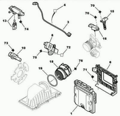

I'm wondering if it could be the Fuel Temperature Sensor - if this is faulty and is sending the wrong temperature info to the ECU, it may affect the fuelling (like when the choke on older cars was in the wrong position and the engine was warm; it would cause starting issues). It is part 1922 G4 and is 13 on the diagram
