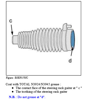

Re: Steering rack tie rod gaiter / boot cracked
TOTAL N3924/N3945 grease
Stu,
Thank you for your reply. My local garage placed a new boot onto my steering rack, however, it does not have the breather nipple, which is on the top right of the boot within the photo you have posted. Does it matter? Thank you.
