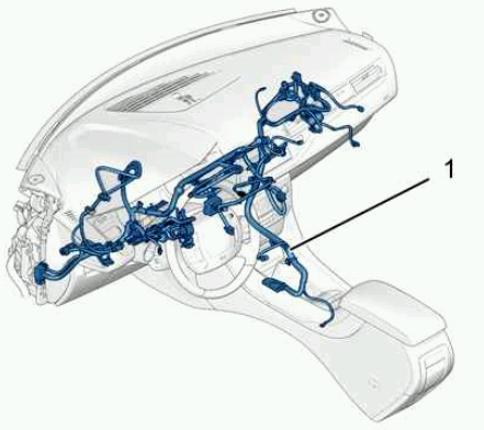

Hopefully this will give you an idea of the intermediate harness on your LHD X7.

How does this intermediate harness relate to the front harness?
Enviado do meu iPhone usando o Tapatalk

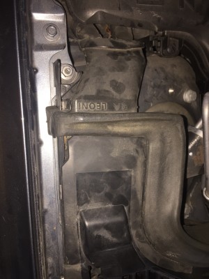

Live feed from battery in C5 X7
There are these two "boxes" (like in pic) that seem to run cables to the cabine (one on each side). Do they conduct cables to the inside of the car?

Can you explain where you have taken this picture as it is hard to determine what it is. I'll have a look later. Also post up your VIN so I am pull the right diagram off.

Re: Live feed from battery in C5 X7
Sorry
These boxes are under the hood, each at one side at the other most position before the engine compartment ends.
The driver's side one is right after the fuse box, after the battery, and the other one is symmetrically on the other side.
Each one "receives" two big looms of cables and "direct" them to near the windshield wipers motor.
I've sent my VIN in private message.
Thanks a lot for your kind help.
AJ
AJ
- x 6955

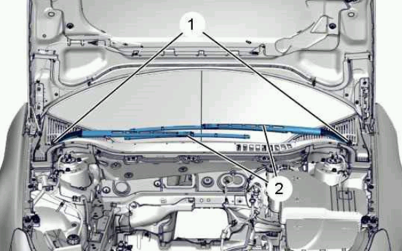

Ok, the picture is upside down, so that confused me - those are the covers that lead to the wiper motors and ECUs (there is one on each motor) as seen at the bottom of the lines indicated at (1):

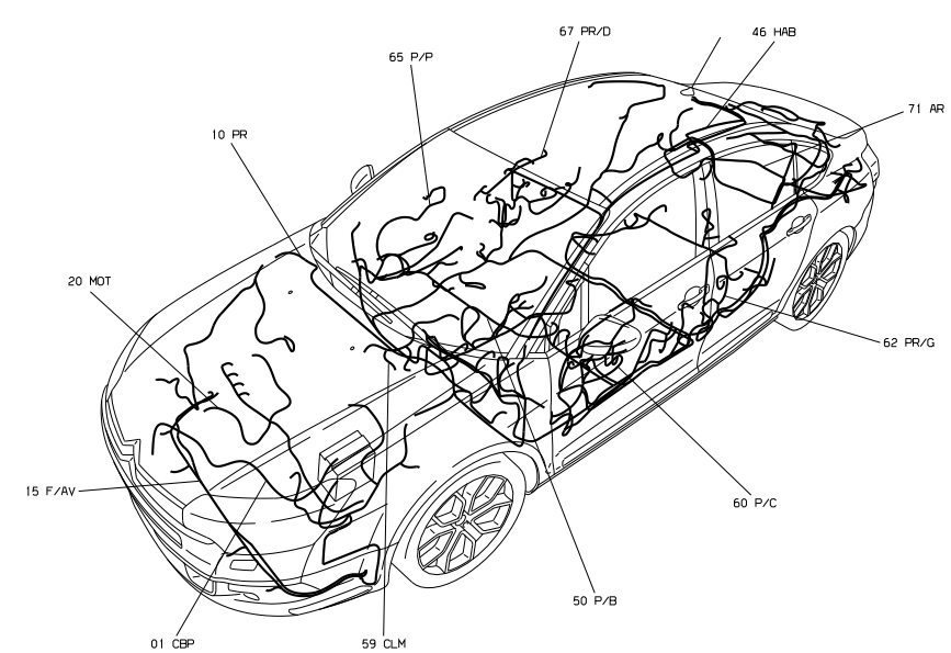

Unfortunately, there are no pictures of the actual wiring looms. The only thing is the locations of the harnesses:
