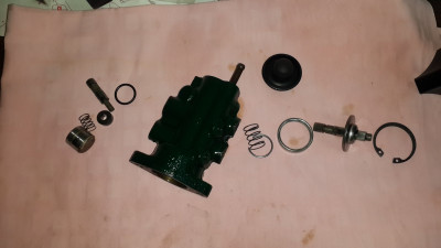

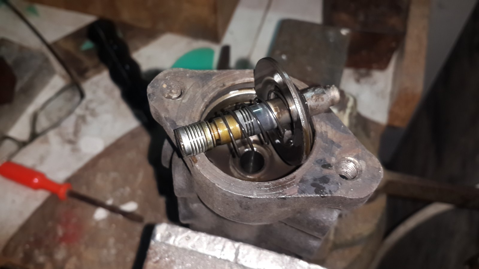

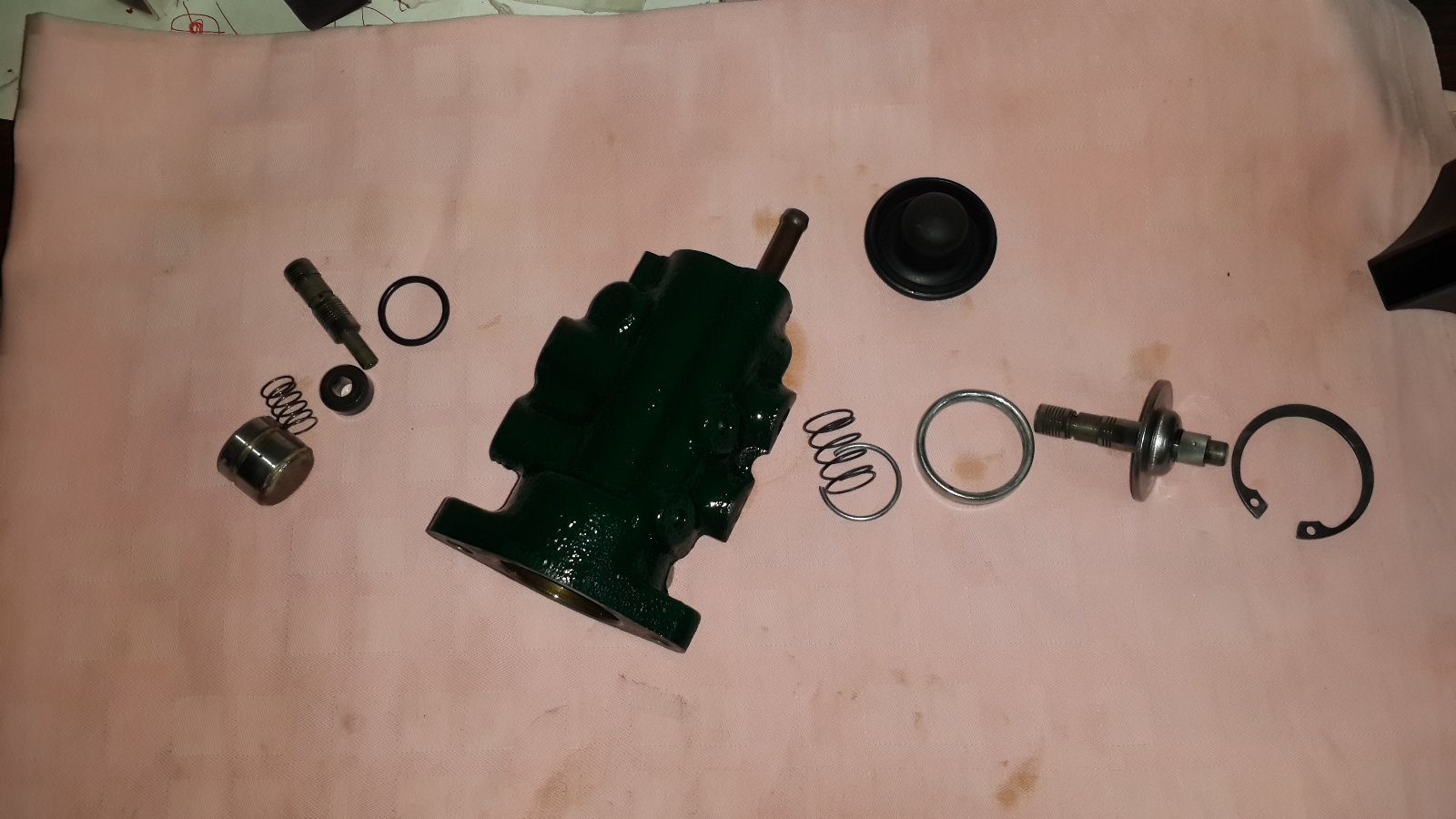

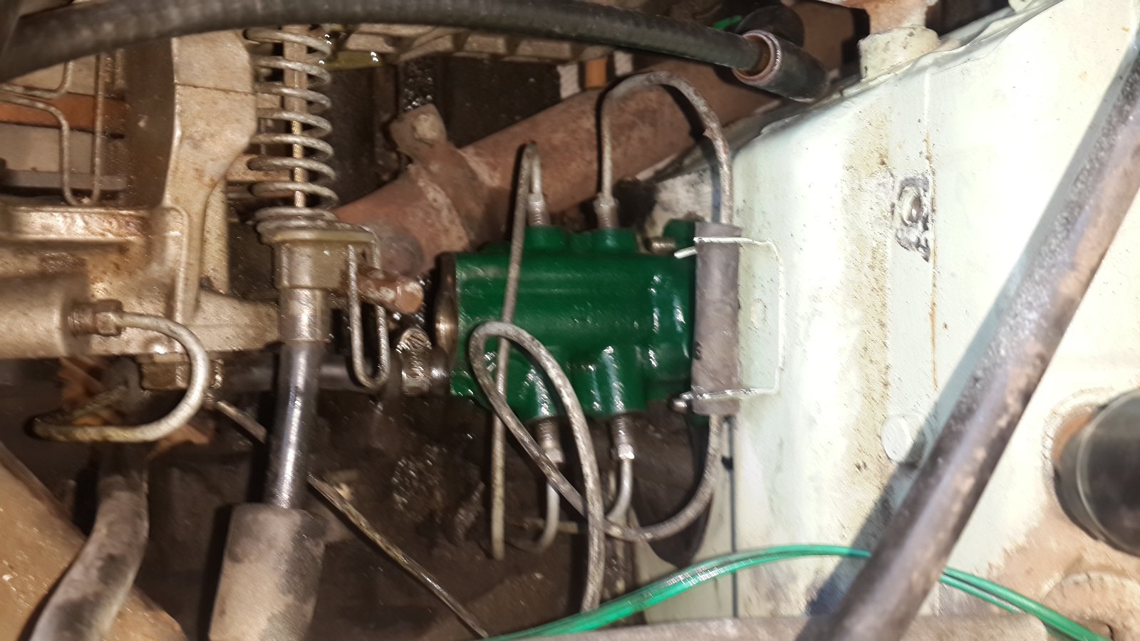

After renovation of the rear brake calipers and the control brake valve, I failed with the MOT test.
The rear calipers are not in function. The rear weels still turning.
I suspect that the control brake valve is faulty...or maybe I didn't bleed the brakes correctly...?
What can be go wrong with the control valve...after all it is a simple pistons..
I would like to have your opinion...

Re: Bleeding rear brakes
Have you checked the condition and functioning of the rear height correcting valve? If it is stuck in 'light load' mode, then no amount (?) of weight in the rear will make the rear brakes work effectively when needed. Loading paving stones in the boot should activate the rear correcting valve (probably one of the easier tests), or as previously mentioned - set the ride control at max height with the rear of car off the ground, spin the wheel and hit the brakes.
Derek
