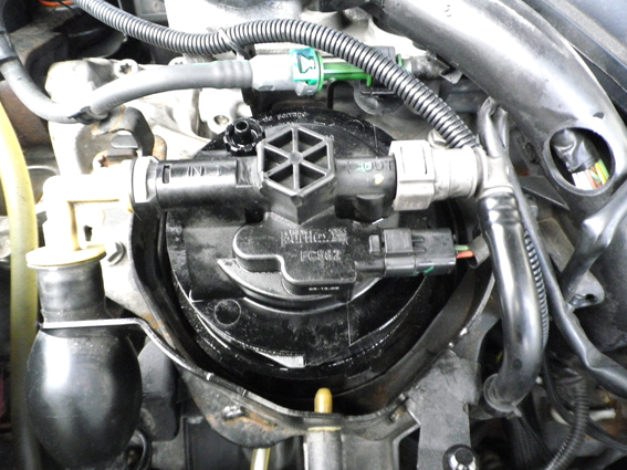

Unread post by petef »
Just tried to change the fuel filter on my 2009 C5 2.0 HDi 138 - the assembly is completely different to the 160, but the same kind of problem remains. Basically the top won't budge. It is screwed in with a large plastic hexagon in the middle of the plastic top, 27mm , same size and idea as the oil filter housing . No amount of force with a 27mm socket and a 40cm breaker bar will shift it. When I say no amount of force, I really mean no amount that I am prepared to apply - as you can see in the photo the edges of the 'nut' have just started to round off, obviously the steel socket is much stronger than the plastic top. It should be impossible to overtighten the top because there is a stop on the outer rim of the filter housing, but I can't get it to shift. Any ideas much appreciated

That filter top looks similar to the DW10ATED (110BHP) setup in my Xantia. The first time I came to change the filter had a similar problem, solved by pressing down on the socket at the same time as turning it with a T-bar. It was as tight as a tight thing :!:
Can you get a strap wrench around the outside of the top ?
Ted
2010 C5 2.0 diesel(163) Exclusive Tourer (133,509miles)
1999 Xantia Exclusive Estate 110 Hdi Mauritius Blue with self peeling lacquer finish (276,174miles)

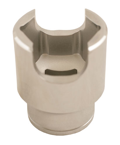

Looks to me that a "special tool" would grip it better, if you have a spare socket or box spanner you could chop 2 sides out of it would allow the remaining 4 faces to sit much deeper on the top and get a better purchase on it.
'96 ZX SX 1.9TD, White, 88k
'98 406sw 1.9TD, Cherry Red, 197k
'98 Ford Fiesta 1.3i 72k
'93 Ford Granada Scorpio 2.9i 135k
Posts: 6794
x 3517
Re: C5 2.0HDi 160 Fuel Filter change?
Laser tools (and probably other manufacturers) do a special socket for the fuel filters. Part number 5270. It gives you a bit more confidence when you need the brute force to shift the filter lid :)
eBay for a gnats under £9.00 delivered.

Just to clarify, the socket I posted above is for Petef's 138 C5.

Special socket now ordered off ebay, will report back on how it shapes up. What a brilliant rapid response, thanks to all. :-D :clap:
