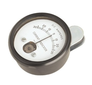

GPs and GP relay would be my first check. Bench-test the GPs, or test one at a time in situ - each one should take about 15A, iirc. Check out the GP relay: look for heat-damaged eye-connectors to its HD terminals (= swollen cable insulation), and clean up all the external connections, and the contacts inside. IIRC there are two pairs of internal HD contacts.
Four good BERUs can pull up to 75A, if all the wiring and connections are good.
As mentioned, one of these Sealey widgets is handy for measuring hefty d.c. currents. It just clips over the cable in question:
They do a 30-0-30 and a 75-0-75A one. I'd go for the latter. On Amazon.uk.
