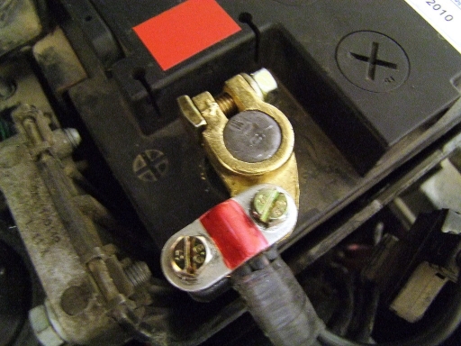

- x 1751
Re: C5 diesel 2003 battery charge fault
You say that jiggling the battery/connections produced a change in behaviour. It does sound like an intermittent connection, affected by temperature or vibration.
If you have original lead (Pb) lump battery connectors, these are known to become corroded inside, where they are crimped on to the copper strands of the battery cables. They also relax their grip on the cable strands over the years. A sign of a problem here is if a connector becomes warm after engine cranking.
If they are the originals, cut them off, strip back some insulation and clean up the cable strands back to bright copper (the copper strands may have become oxidised/blackened)***.
Replace with some brass clamp-type connectors, like these (Halfords, motor factors...):
A bit more careful wiggling might tell you which connection is at fault. Replace both anyway.
.A bit more careful wiggling might tell you which connection is at fault. Replace both anyway.
