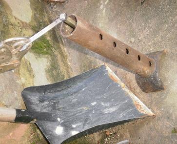

Well I'm quite pleased with myself, stage 1 of the 2.0HDi Timing Belt Tensioner tool has been completed.
Here is the evidence....
Stage 2 hardly worth documenting saw the key steel to the appropriate length.
Can I claim my "FCF home blacksmithing with limited equipment" badge?
Abracadabra! Works a treat.Method:-
Get the inner bit from an axle stand and place it upside down on a flat surface.
Drop your 1 foot long 8mm x 8mm piece of key steel into the open-end.
Find a hammer and have it ready.
Select an old 3/8ths ring spanner which you haven't used since 1978 from your toolbox.
Grab with molegrips, switch on gas ring no 4, poke the ring end of the spanner into the flame and let it lie while you have a cup of tea.
Return to the cooker and see if the ring end of the spanner has turned a dull cherry red.
Move swiftly from the cooker to the "forge" and hammer the ring end over the square section key-steel.
