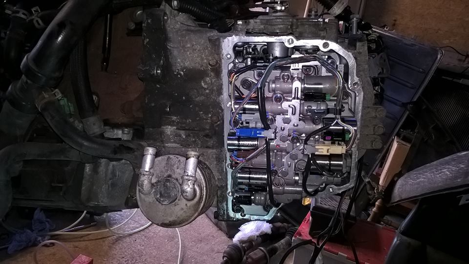

It's been a good day today... A nice run out in the Activa to visit Team WFA and do a bit of work on a C5...
Namely replacing the valve block in the Aisin Warner 6-speed autobox.
The engine and 'box was out of the car for other reasons - failed turbo - so whilst at it some value-addeds were done, the gearbox being one.. The valvebolck electrovalves wear over time and make the gear-change a bit ropey on occasion.
New valveblocks are expensive at £450 but against that, it's allegedly the only thing that ever gives trouble in the 'box so it's not too bad overall... A cheap fix compared with a new car or autobox...
It's an easy job and can be done in-situ
I've brought the old valveblock home for a bit of a look at and to see if anything can be done with it.
We also did the cam-belt and water pump whilst the engine as out. A very easy job indeed
I very much enjoyed it all...

Urrgh! Failed turbo. What engine was that Jim?

2.0HDi...demag wrote:Urrgh! Failed turbo. What engine was that Jim?
Practically unknown... We believe it was metal fatigue in the shaft or a manufacturing defect... No shortage of clean oil or anything like that...
Basically the inlet compressor impeller fell off and went walkabout in the housing with predictable results...

It's not unheard of in a 16v engines but never seems to happen in the 8v units. Could be from heat cycles I suppose as the only. If differences are the head and the turbos themselves changed, but the 16v units are designed to warm up quicker as well to help keep emmissions down and fuel economy up.

My current 2.0L HDI C5 had the turbo blow for no apparent reason, a lot more damage afterwards when the debris got into the oil galleries and caused the big ends to fail.

Nasty...Gibbo2286 wrote:My current 2.0L HDI C5 had the turbo blow for no apparent reason, a lot more damage afterwards when the debris got into the oil galleries and caused the big ends to fail.
Hopefully, the way the turbo went it looks like none of the bits got into the oilways... The debris ended up in the inlet tract but did not reach the inlet valves...
