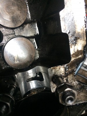

You can see on the block pics, the nasty marks in the pistons left by the INLET valves. Also please note the condition of said inlet valves on the head, they've not hit the pistons any time recently I would say?
Overall the engine looks to be in good as new condition save for the gouges in the head and the damage down below, more's the shame as it really was a sweet engine by the look of things
One other anomaly I can't fathom yet, my initial worries about a bent/dropped inlet valve on #1 (the lifter seemed to sit 1mm+ lower than the rest) seem to have been unfounded since the valves are all sat nicely and sealed when I blow down the inlet so why would it seem to have a HUGE clearance compared to the rest? could the piston have hit that hard that the valve has just completely "mushroomed" inside the guide in some way, or could it be a replacement valve different to the rest? Picked up my valve spring compressor today anyway so will look into that at some point, just after ideas really... Enjoy the carnage, more to follow (of that I'm sure)

The way the piston on the left of the photo's is way down the bore all on it's own looks quite disastrous to me.

The one on the left is OK, it's the one on right that's at the top when it's not supposed to be, and has rotated 15deg to left that is looking sick!!

Oh my goodness yes, definitely big bottom end issues there...

You know, having read this and then gone for a run - a great time for thinking things through
- I have a belief the bottom end may have let go first and the cam breaking was a result and not a cause...
Can't wait to see what removal of the sump reveals

I have seen an (old) ford engine that looked like that, and the only bottom end damage was a broken piston with a detached crown. The rest of the piston and rings were still happily traversing up and down the bore.
