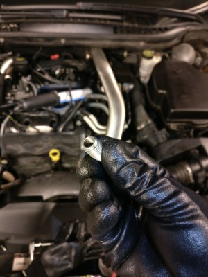

Hi to all.
Thought I could share a little story about how things can go wrong with a simple task of changing glow plugs to my 2.7HDI. Simple job to strip top of the engine and just change these... Or so I thought.

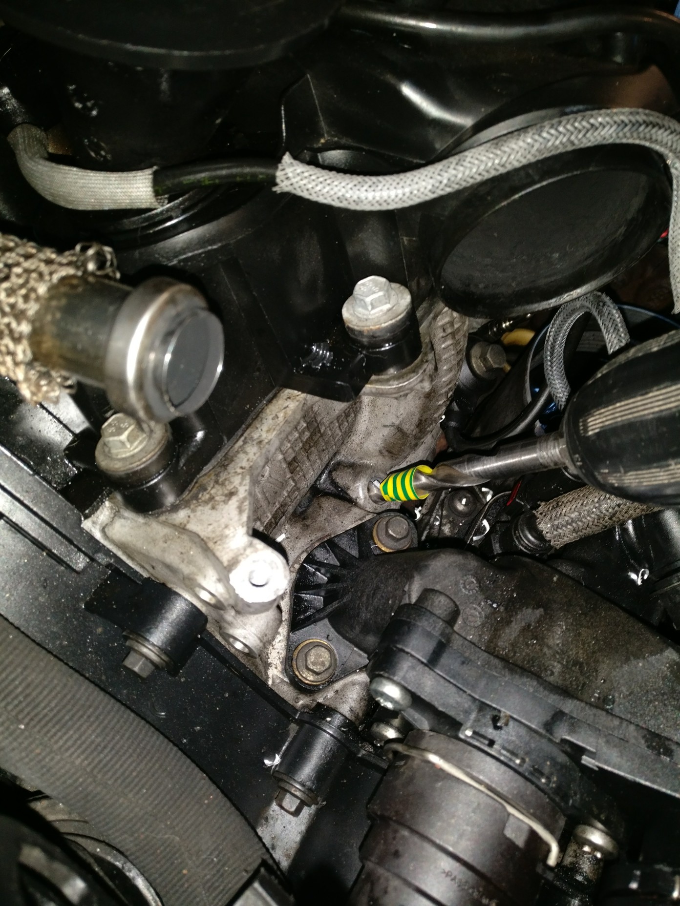

Two of the glow plugs were already broken by previous owner and one I broke while twisting it open. Glow plugs snapped right above the threads.
No way I was going to strip heads from the car as it is pretty difficult task to do. Easier would be just to lift engine off if starting to do that.

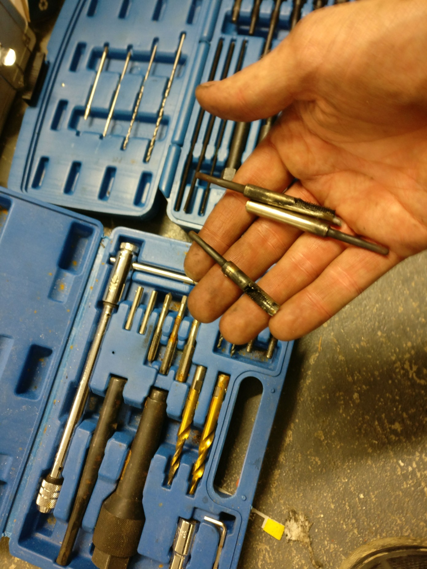

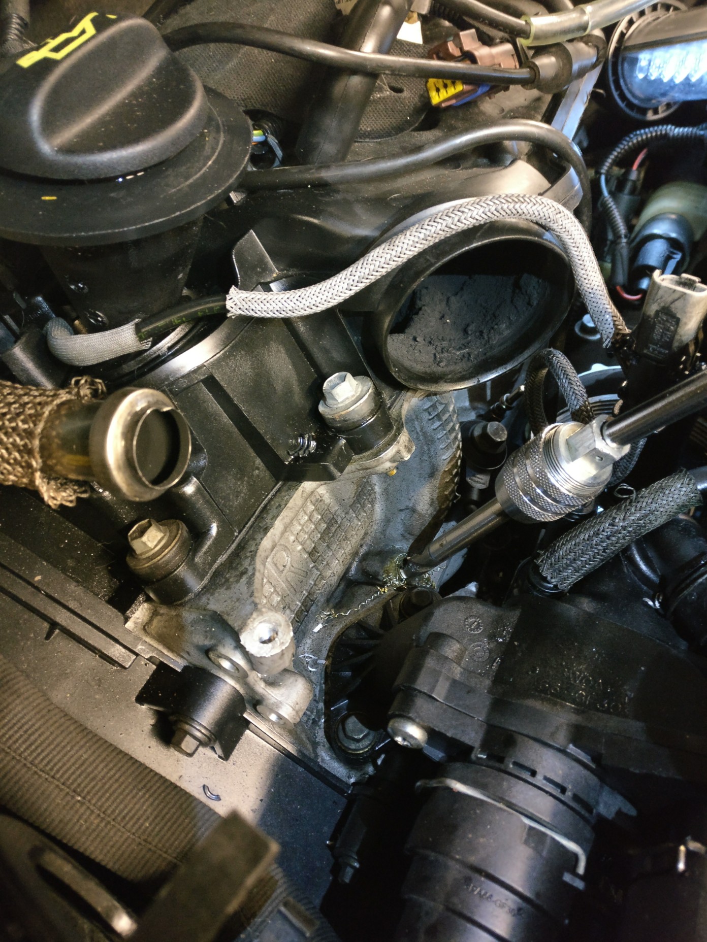

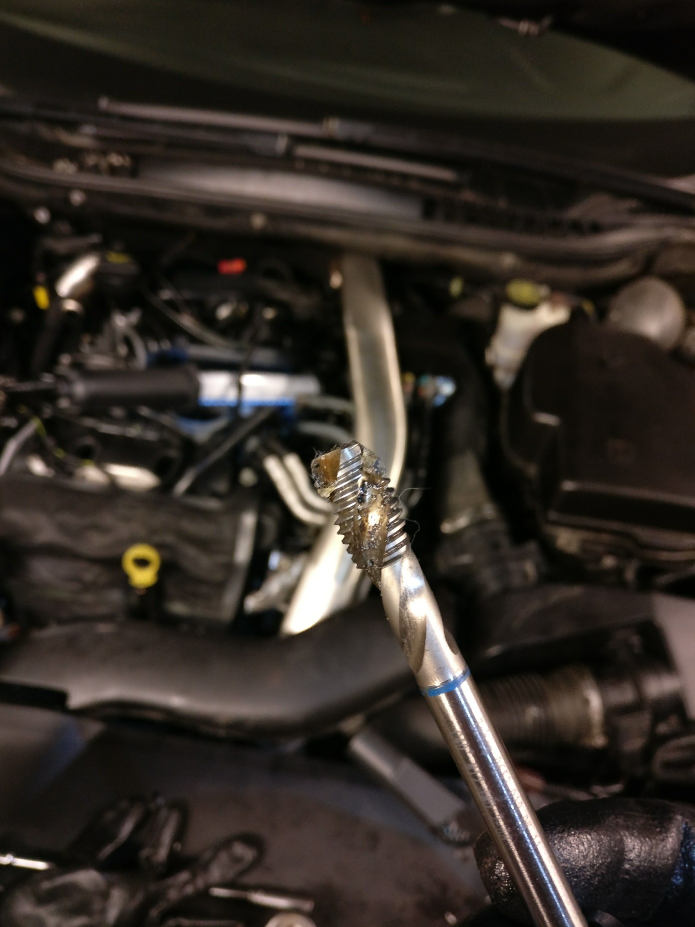

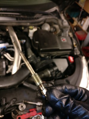

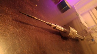

So I ordered broken glow plug removal set and glow plug tip removal set from Laser tools.
After few hours of work and with little extractor modification, I got the broken glow plugs pulled out.
Broken glow plugs removed and extractor sets on background.
I was so happy that I didn't need to strip cylinder heads from the car.

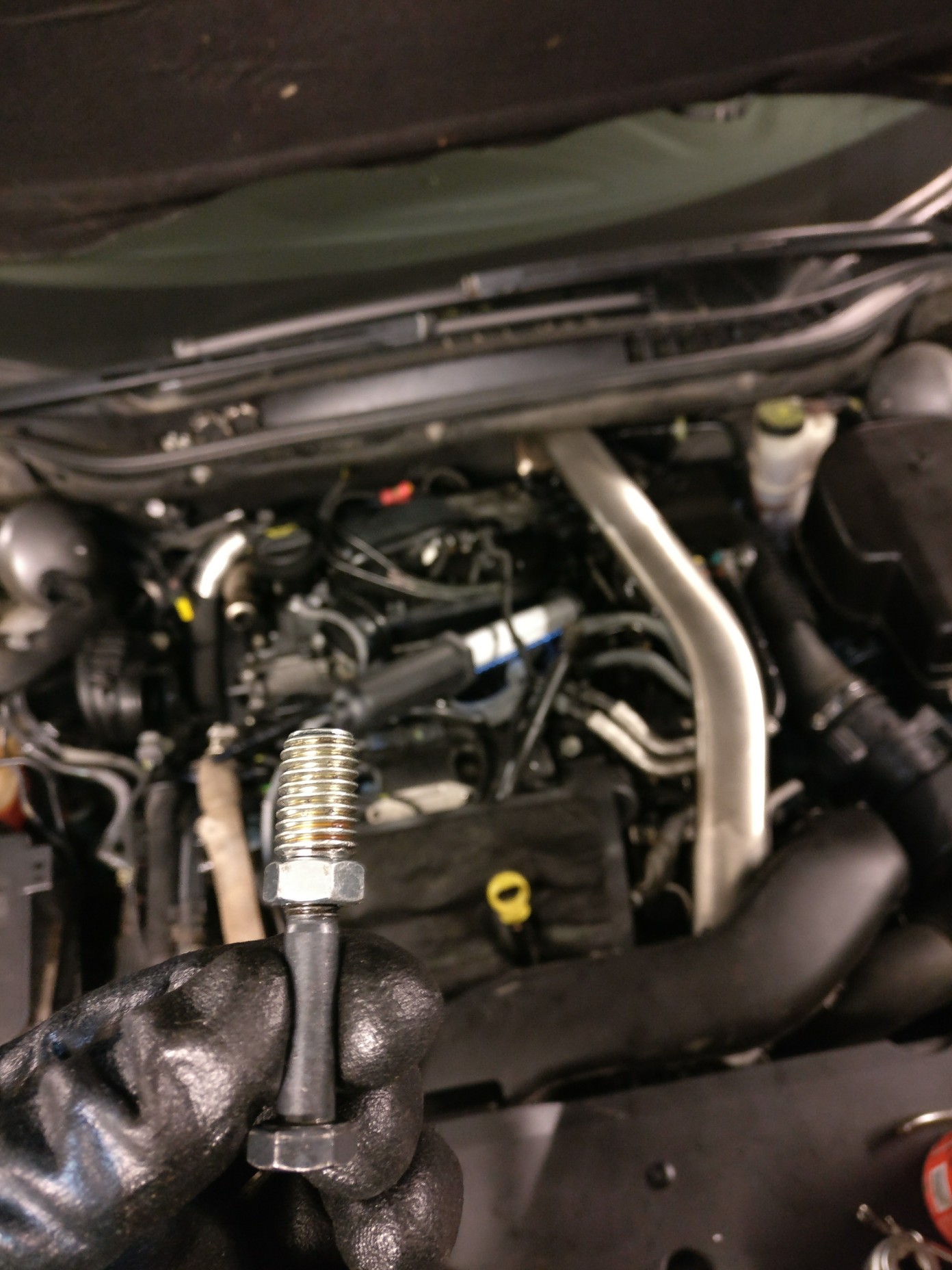

I did it with a nut and bolt. Screw nut to the bolt and bushing against the nut and tighten the nut to the bushing. This way you can tighten the bushing in place, loosen the nut and remove the bolt.
Bushing tightened to bolt with nut. This way you can easily tighten the bushing in place, loosen the nut and remove the bolt.

These were the two sets I used, first is for glow plug removal and second one was just a precaution in case that I snap an tip while extracting those glow plugs:
http://www.ebay.co.uk/itm/390990194007
http://www.ebay.co.uk/itm/262699021026
Two videos on how these work:
My initial idea was that if the first extractor won't work, I'll then use the second one first to drill and tap into the electrode and then really gently drill almost all of the body out, extract the electrode and clean the hole. But as I found out and because of previous jobs removing broken glow plugs from removed cylinder heads, I knew that after I get the threaded part drilledout off with just about 3cm body left in, it comes of with little effort.
Good thing with this engine is that I had the room to do all this. Not sure how your 2liter engine is orientated.

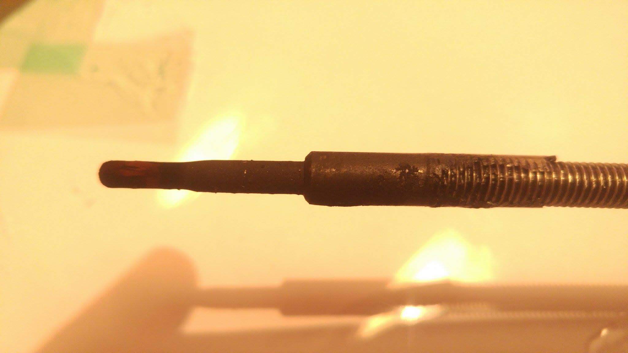

But like said in the original post, had to tweak the extractor a bit. One of the glow plugs was so tight (that shortest on the photo) that after tapping it and trying to extract, threads gave up and extractor slipped of.
I knew that it needed just a bit of twisting while tapping it up and down to start come off so I drilled a little further inside the glow plug body and tapped with left handed thread. Screwed an left handed thread bar inside the body and attached that to self made slide hammer. Then just gently counter clockwise twisting (bar screws even more tightly to body while body starts to loosen) with tapping gently with slide hammer and it came of. Next thing would of been to drill the whole body out and trying to extract the electrode but happily there wasn't need.
Sorry for not having any photos on this procedure, it buggers me a bit that after all that pain in the *** job, didn't take any photos to help others.
But main thing is to stay calm. The body is stuck quite firm on those threads inside the cylinder head that reach quite deep with a bit of swelling at the tip of the glow plug body.
You just have to drill the threading part from the glow plug of and then I suggest that you modify a sliding hammer to tap the plug out.
That screwed to pull extractor isn't best because of the static pulling motion without any vibration.
Vibration combined with pulling motion is the second best option. Best is the one mentioned, left hand threaded bar screwed inside the body with sliding hammer attached. Then you can apply counter clockwise twisting combined with vibration and upward pulling motion.

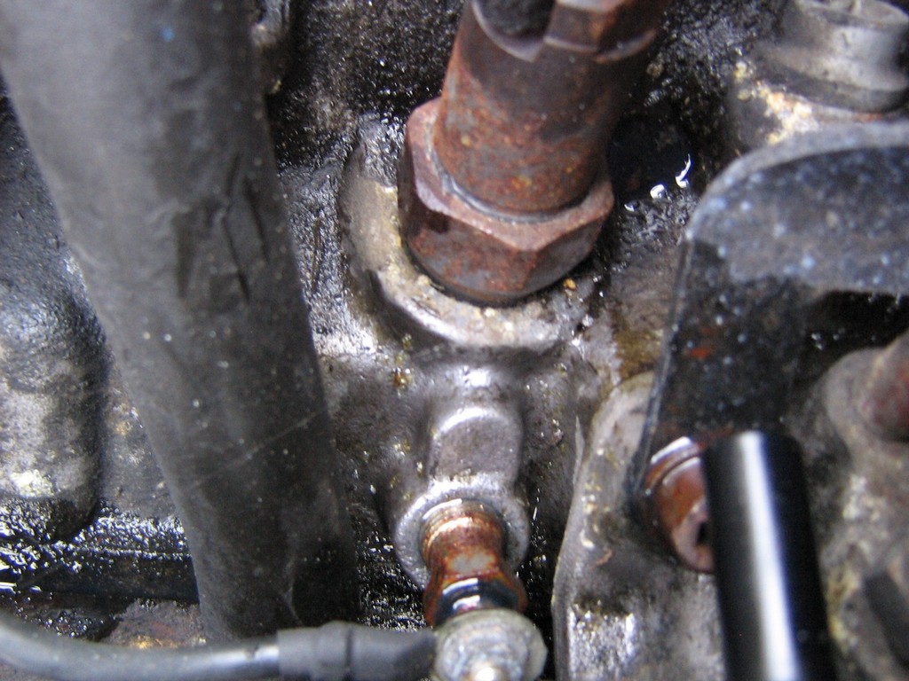

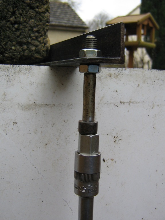

Thanks for the suggestions Guys (have we got any 'Girls' here?)

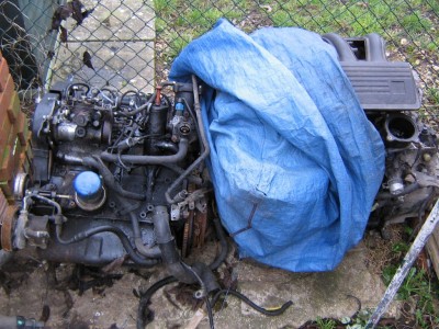

Laid the engine back and slathered a loada diesel around it for the mo, leave it a couple of days & have a go me thinks, Glowplugs are shiny implying poss' recent-ness. I note with suspicion that No.4 / 1 (Gearbox end) has at least 4 threads showing where others have only 1.
Was out there 'practice welding' a threaded rod joiner to a Torx Bolt to mimic the one that I can't get out of my Drivers Door top hinge. Went really well, didn't break when I gave it some welly with a socket & T-Bar. Fingers crossed for the 'real thing' soon.

One or some kind of neat combination. :D If you look at my broken plugs, one that is shiny came of without any effort after I drilled the thread out as its seal has kept. Two others had carbon buildup between insert and the body and those needed a lot more persuasion after drilling.

Thanks Finguy for the detailed advice and link. Appreciate the time you took with it. Fingers crossed for the actual removal :)
Edit 25 Feb.... they came out lovely, perhaps in part for the laying the engine on its back and a liberal application of diesel around the threads, but who's to know.
I took the Fuel Pump off first (Lucas Roto) and put it aside to carry 'just in case', noting that none of my extensive collection of bolts seemed to fit the holes in the pulley to thread through & push against the head to facilitate getting it off if its stubborn. Thankfully, it came off easily anyway, but its a bit weird. Anyone know what size they are, maybe imperial?
