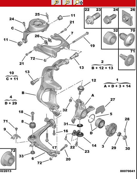

Chris_H4922 wrote:Thanks for the reply. No signs of leaking. I dont have hydractive suspension so that rules out potential problems there. The Power steering fluid level has not changed. There is a quite squeek you can hear on the inside when turning the wheel. Like i say, it was fine when i started driving it again and then became lumpy after driving for a while.
Squeak on turning ?.....check the lower swivel joint and the arm bushes.
Check the lower joint with the wheels on the ground using a lever, there should be zero movement if it is OK..part 14 in the image
