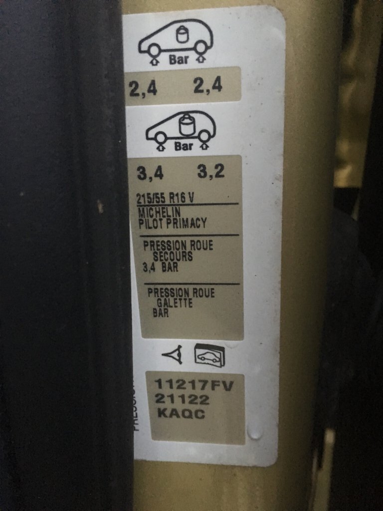

Hi thanks for the reply, I believe it is one of the codes below?

The RP code is 11217FV, and shows that your car started life on 26 July 2007, in the Vigo (Spain) factory. I got this information from the RP calculator site;
