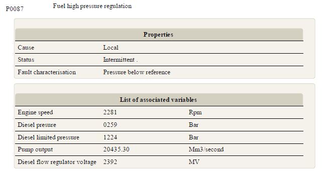

I put on my rather ropey Diagbox and see the following 2 errors:
Any advice or help gratefully received. I'm hoping it might be a seal gone that's letting air in and gravity is letting the fuel fall back into the tank.

When was the fuel filter last changed? Those fault codes look like those generated when the filter is a bit blocked. If there's a bit of a leak on it somewhere that may account for poor starting. If it's not been changed in a while, then I would put a new one in (not all that easy!) and see where that takes you.

Sorry for late reply - yup it was the fuel filter - thank you
