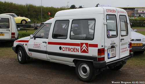

Hundreds of C15 vans (mainly C15D, RD) are on the roads here, mainly white or silver. I love the look of them, but think they would be vastly improved with some slightly wider tyres, especially when seen from the rear. The version with the extra seats and side windows looks good too, and is popular with farmers' families. Nothing much rusts here, which helps.
Some neighbours of ours had one with not only a full set of side windows and rear seats, but also a set of roof-edge windows (a la Rancho and Discovery). I missed a chance to buy it when they moved to Oz.
