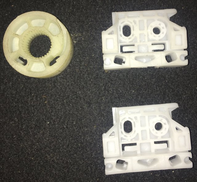

Hi all, I recently bought a window regulator repair kit for my C5 X7 from eBay.
I start replacing the cables but I realised the pulley on the electric motor fits in only one position. In than position is impossible to get the cables around it. Therefore I'm assuming they sent me the kit for the other
door. Also the plastic parts that hold the glass and slide up and down don't fit either.
My faulty window regulator is on the driver/right side door. The seller is insisting the part is for the specified door.
I can only put a pic of the remaining parts here, so you maybe can see if I'm wrong or not.
Many thanks
door. Also the plastic parts that hold the glass and slide up and down don't fit either. My faulty window regulator is on the driver/right side door. The seller is insisting the part is for the specified door.
Many thanks

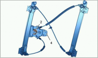

Here's the diagram that would seem to suggest the parts are correct ... (Click to enlarge)

I think the complete kit comes in pieces and you will have to assembly it. I can't imagine a way to keep that cable under tension

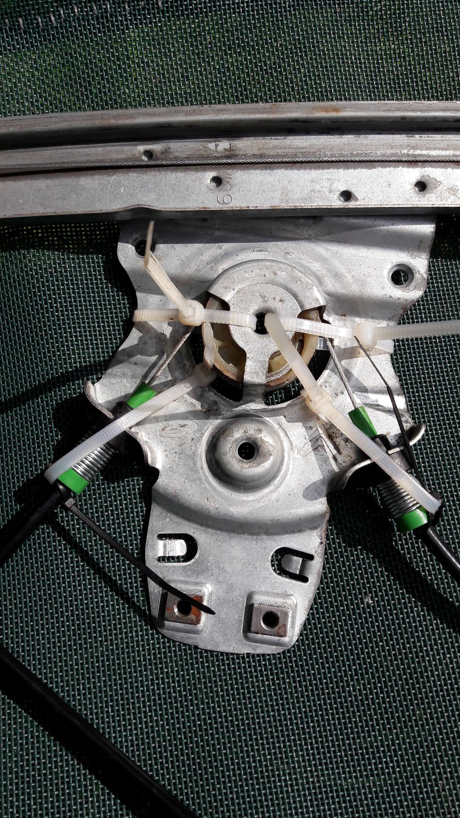

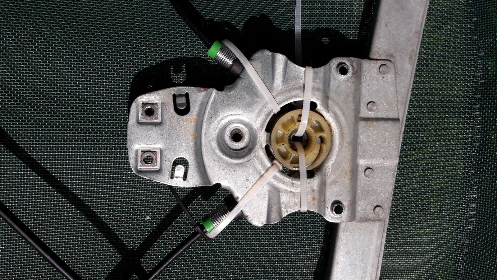

Although I went the same route and bought the frame (minus motor), I decided to have a go at re-threading some new cables onto my old frame. It was an awful lot easier than I'd been led to believe
I found it easiest to hold the springs compressed by using a couple of cable ties on each spring, then lace up the cables, then the last job was to heave the central reel into position. It does help if you can grow and extra hand for part of the re-threading, but a small well-trained child or wife / partner is equally as good
