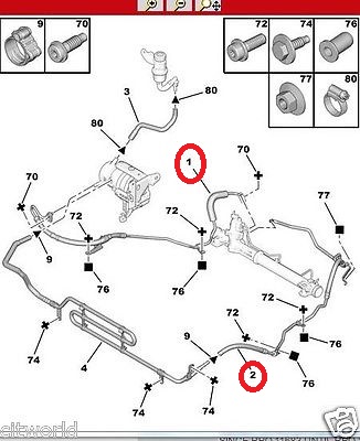

- x 6957
Re: Another C5 X7 suspension repair
Looking at the diagram, I can only see a point of contact directly at the rear of the rack where they enter the rack itself where the 'marching ants' are. How these rub together though is confusing as you say..

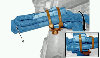

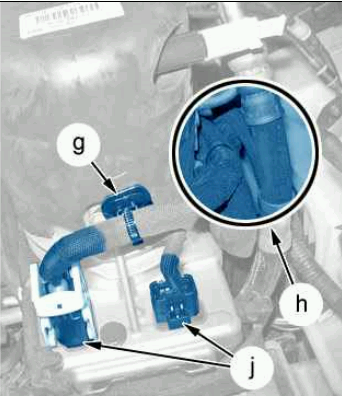

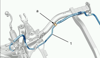

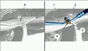

Just done a little research: It seems that there were a couple of mods made about 2009 (and I'm not talking about the new steering rack design as we know that was faulty on much later models). One was the fixing of the power steering pipe on the subframe and concerned replacing the old bracket clamp style with a simple cable clasp: I can't see how this would cause or make any difference to the pipe working loose as the other pipe is miles away!
Secondly and this is more interesting - there was a modification to the Power steering electro pump connector. It seems that inside the plug, they have modified it to space the electrical pins apart. The interesting part, is that they show how the power cables are to be taped up afterwards with a specific mention about ensuring they do not make contact with the power steering pipe. Now that would make more sense if this was not done properly and would cause the electrical power cables to rub against the PS pipe! This is where is it located in relation to the PS pipe: Close Up:
So if this was not taped up correctly - there is only a small gap between the electrical taping / cable tie and the rubber PS pipe.....
I just can't see how the pipes the mechanic showed in the original poster's diagram can touch each other as they are are routed around the vehicle differently!
