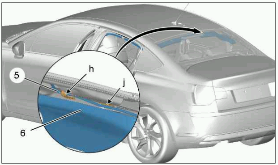

The aerial path runs from the rear Driver's side through the back rear headlining and then down the passenger side to the front:
Ah I think we are getting somewhere. I've noticed a ripple in the head liner rear passenger a pillar. I suspect it's been pulled down at some point.

When you say pulled down Ben - if it has had a side impact it is very likely that the Side Curtain Airbag has deployed! It is therefore possible that the wiring loom may have been pulled out of the aerial unit or elsewhere - so a bit of careful detective work is needed - and be VERY careful whilst working near airbags. :shock:

Paul-R wrote:In your case I doubt it would have damaged the aerial unit/amplifier although doesn't mean that it hasn't gone wrong for another reason. If there is damage it's more likely to be the antenna lead itself damaged depending on where the impact was.
When you look at the diagram the loom goes right through where the airbag explodes - so it wouldn't be past the realms of possibility. Some careful back tracing needs to be done - but the headlining is very fragile. When you got the car - was the side airbag replaced I wonder. In either case, the aerial and the wiring has to be the cheapest place to start troubleshooting - you don't even want to be asking me how much a new NG4 head unit is.
