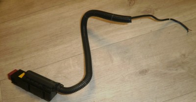

Thought the forum might assist here...from one of my fleet...not French but a common "problem" sufffered also by a French member of the fleet.

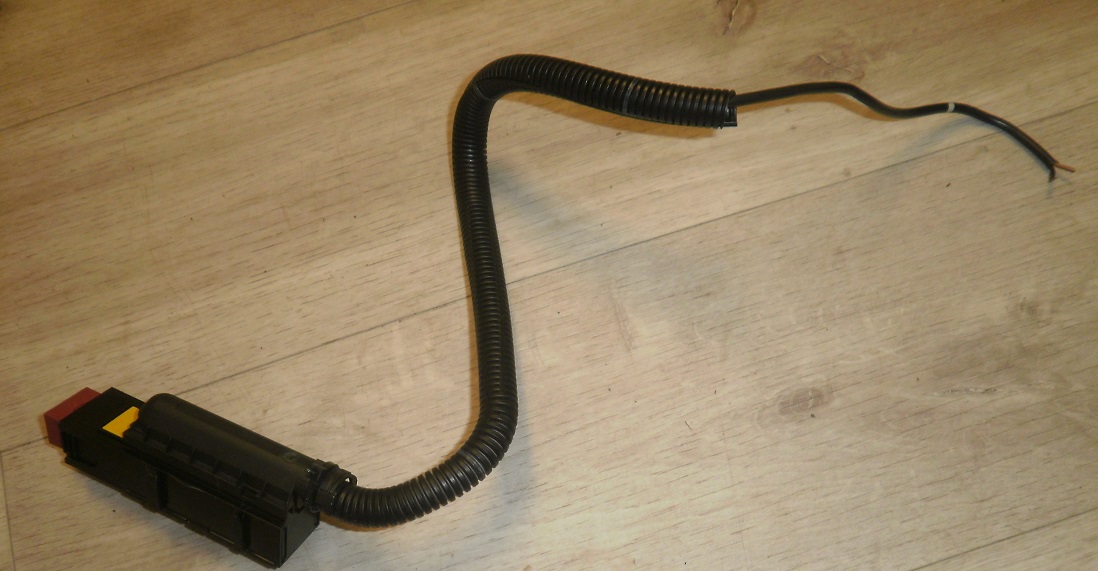

This is what I know. Especially on 2-door cars, where the front seats are regularly moved backwards and forwards, the wiring and or connectors associated with the pre-tensioners routed under and around the seats, are subject to physical damage which manifests itself with the Airbag light being on. As can be seen from the photo this physical damage was a complete severing of the wire.
Now I reckon "Main dealers" love an Airbag Light on job...licence to print money. First of all a diagnostic fee for the all of 20 seconds it takes to do one. Then the chance to fit some eyewateringly and unnecessarily expensive parts.
Can't get the wiring seperately on this model, so for the wiring and the pre-tensioner for one of the most popular small cars in the UK lets say over £200 plus VAT for the necessary bit.
Thankfully, loads available second-hand, pulled out of scrap cars at £15-£30 quidish so thats what I'll be doing most likely, but....
Would repairing the wire be a decent alternative option?
Looks like a two-core thin walled cable something like this
Can't find the exact spec for the cable, as fitted in the car to the pre-tensioner so not sure what current rating would be appropriate. Its pretty thin stuff really and the circuit is protected by a 5A fuse.
For potential joining of the conductors I was thinking along the lines of twisting and soldering the wires and surrounding the joint in heat-shrink. Are there better/neater ways of joining thin wires?

I did exactly that on my Berlingo 3 years ago, and it was, and still is fine..NewcastleFalcon wrote: For potential joining of the conductors I was thinking along the lines of twisting and soldering the wires and surrounding the joint in heat-shrink.

Thanks Mickey. Just imagine if a main dealer offered that perfectly acceptable solution....mickeymoon wrote:I did exactly that on my Berlingo 3 years ago, and it was, and still is fine..NewcastleFalcon wrote: For potential joining of the conductors I was thinking along the lines of twisting and soldering the wires and surrounding the joint in heat-shrink.
Parts wire/solder/heat shrink........50p all in!
Never going to happen is it?

I don't see any harm in using a similar wire, I'd choose a multicore rather than the single core in the link so it can flex more easily. The circuit is simply on or off rather than measuring a resistance so nothing should go awry.

I've done this many times and as Mickey says, it works perfectly well...mickeymoon wrote:I did exactly that on my Berlingo 3 years ago, and it was, and still is fine..NewcastleFalcon wrote: For potential joining of the conductors I was thinking along the lines of twisting and soldering the wires and surrounding the joint in heat-shrink.

Thanks James/Jim/Mickey that's reassuring. Fix the bit that's broken
Now if I wanted to get a bit of twin core thin walled cable of an appropriate current carrying rating off the high street where would I go? Maplins do have 3A cable which looks pretty similar, but is this too "low" for the job?

That 3A cable will be absolutely fine Neil, the main thing is it needs to be nice and flexible. The current flows are negligible... The only time any appreciable current flows is if the thing is triggered and even then it's not much - certainly well within the capability of the Maplins stuff..
The most important attribute is that it's flexible and can stand up to much seat movement...
