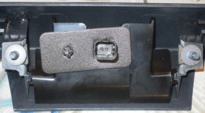

It's broken! To be more precise, it's stopped working; we've only had the car 2 weeks. Parked the car this evening in the twilight, boot refuses to open; earlier in the afternoon, the tailgate 'handle' was a bit iffy in engaging the switch, - now the handle just rattles around and won't engage the switch.
I remember reading a comment somewhere about the C4 Picasso's notorious tailgate lock. The car's still under seller's warranty, but it's a 320 mile round-trip, so it makes more sense to ask them the pay for the parts if I fix it.
Can anyone tell me what the typical failure mode is please? What comes undone or breaks? In the latter case, it looks to be a choice between the plastic handle assembly (8726 V7) or switch (6554 ??). Is there any way to tell without dismantling the tailgate which version of the switch is likely to be fitted (service.citroen is unspecific despite quoting the VIN)?

If it's floppy, it's the handle - you way well find you can make it work by pushing the handle forwards then lifting it to trip the latch. They're pretty weak - ours has been broken ages, but we can still open the door by pushing the handle forwards. The trick to not breaking the new one is to not use it to lift the door - do it via the light rail adjacent to the switch instead. IIRC you have to take the door interior liner off, then the trim strip across the outside of the door (about 8 fiddly bolts on the inside) which then gives access to the lock fixings. This shows how; he repaired it but mine was definitely broken beyond help. I think it's just a 2 wire affair, so a simple piggy backed switch should do the trick if required.

What I didn't know when I bought the car was that a loose tailgate handle is broken and than very soon it will break off the operating pin on the relay.
The parts are expensive from Citroen:
I didn't need to remove the tailgate trim completely: after undoing the 2 plastic rivets (either side of the latch), the T20 screws in the interior handles and un-popping the dozen green plastic trim-fasteners (big flat screwdriver wrapped in a layer of thick (Gorilla) gaffer tape, I could fairly easily slide both arms inside the tailgate and undo the 6 x M6 nuts that secure the plastic moulding (the brackets for two of these had broken off the main moulding - now glued back in place with generous fillets of Aradite).
Parts probably won't arrive until Tuesday but I can live with that. If I need to open the boot, I can operate the electric mechanism with a shorting link (aka paper-clip); quite secure as the circuit is only powered when the central locking is open.

The dealer from whom I bought the car has willingly agreed to pay for new handle and relay. Parts from Desira ordered through eBay on Wednesday afternoon, arrived this afternoon by 1st Class post. This Peugeot dealer very sensibly swaps out the square-body micro-switch (widely used on other models) for the round-bodied switch fitted on the vast majority of C4 Picassos.
When I removed the moulded-plastic trim/housing from the tailgate, I found two of the mounting brackets were broken off and a third was partially fractured. Incompetent design (over-thin sections and lack of web radii) compounded by poor quality control (gaps in some over-thin sections). I've re-fixed the broken-off brackets and beefed up the joints to the external body with Araldite, so hopefully no more brackets will break off.
Failed, but still attached, bracket Broken bracket 'welded' back-on with Araldite Handle plus switch installed in trim ready to refit (note weld on cracked bracket) On Saturday morning, I fitted the new switch to the handle, handle to the trim, then outside to test the switch (OK), refit the trim (no problems), thump the the plastic 'pop' fasteners back into place, play hunt the fasteners in the 3rd row seat wells then fit them. Under an hour all told.
