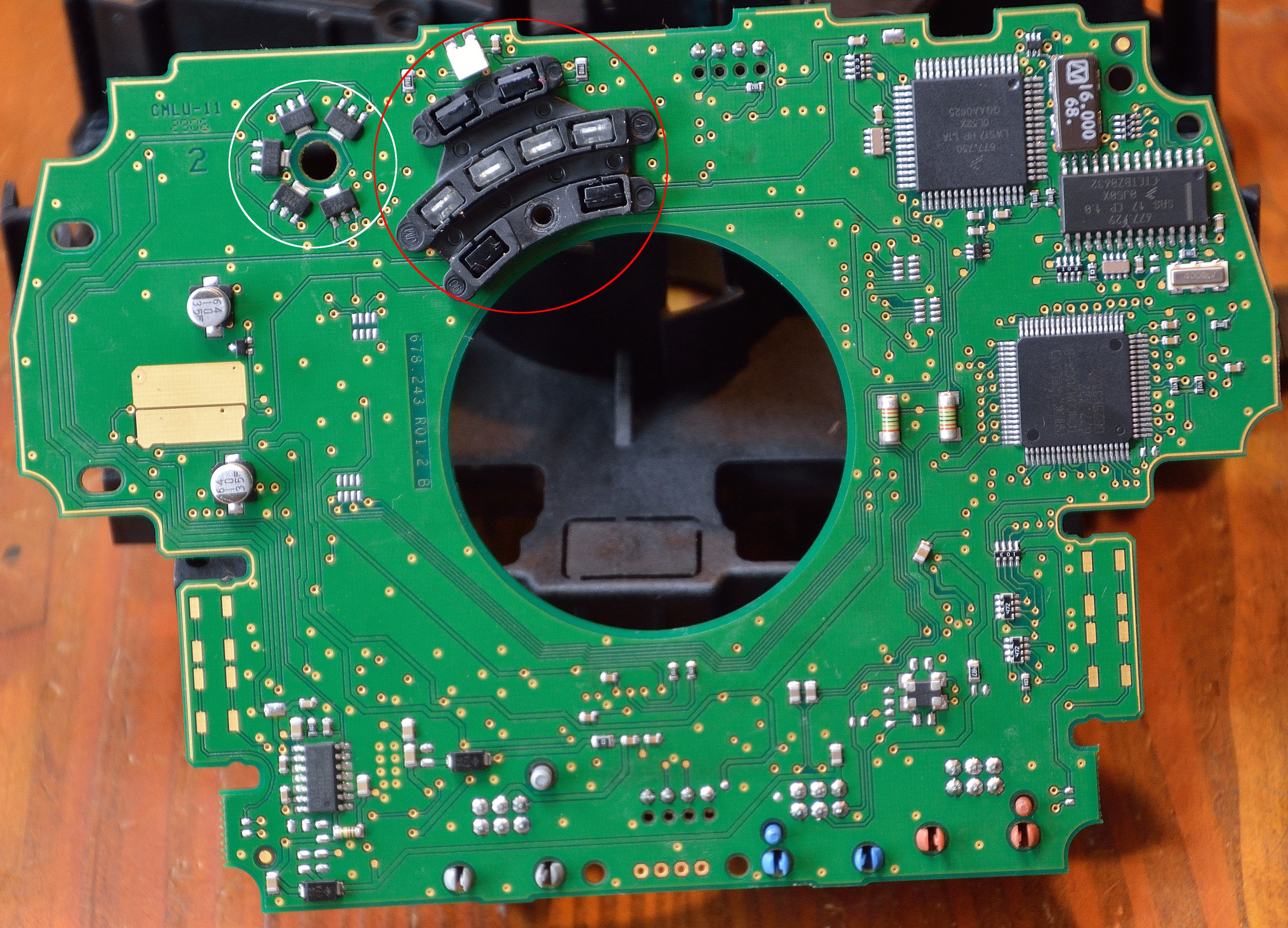

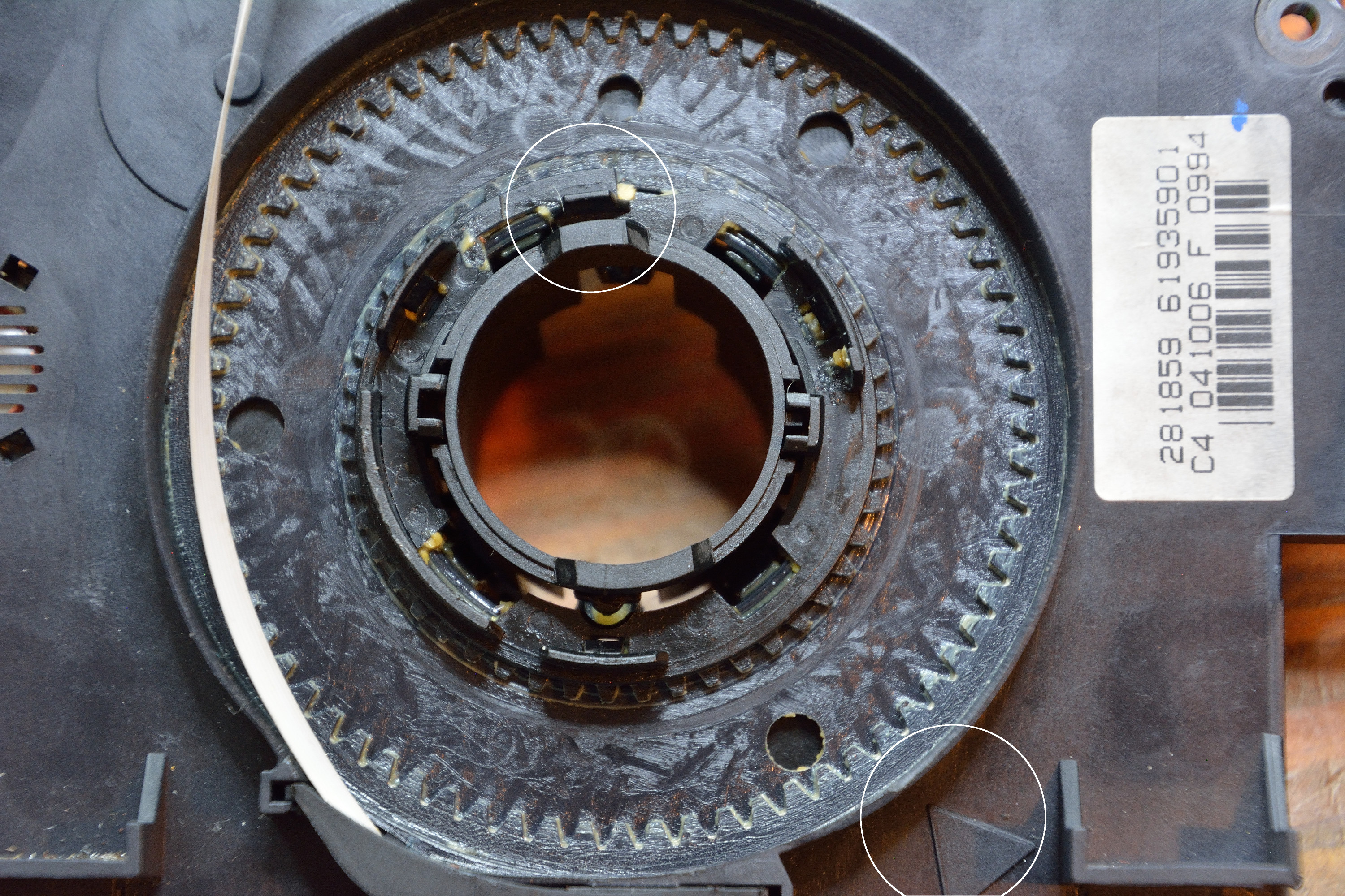

Just want to share my experience inadvertently pulling apart the 'clock spring' ribbon cable and geared mechanism and supporting pcb that handles the steering wheel angle sensor, steering wheel column switches and airbag/horn wiring connection rotation.... Now im not 100% this is the way to put it all back together, but it works for me, so if you have take yours apart, make sure to take note of the way its put together.

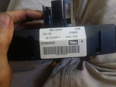

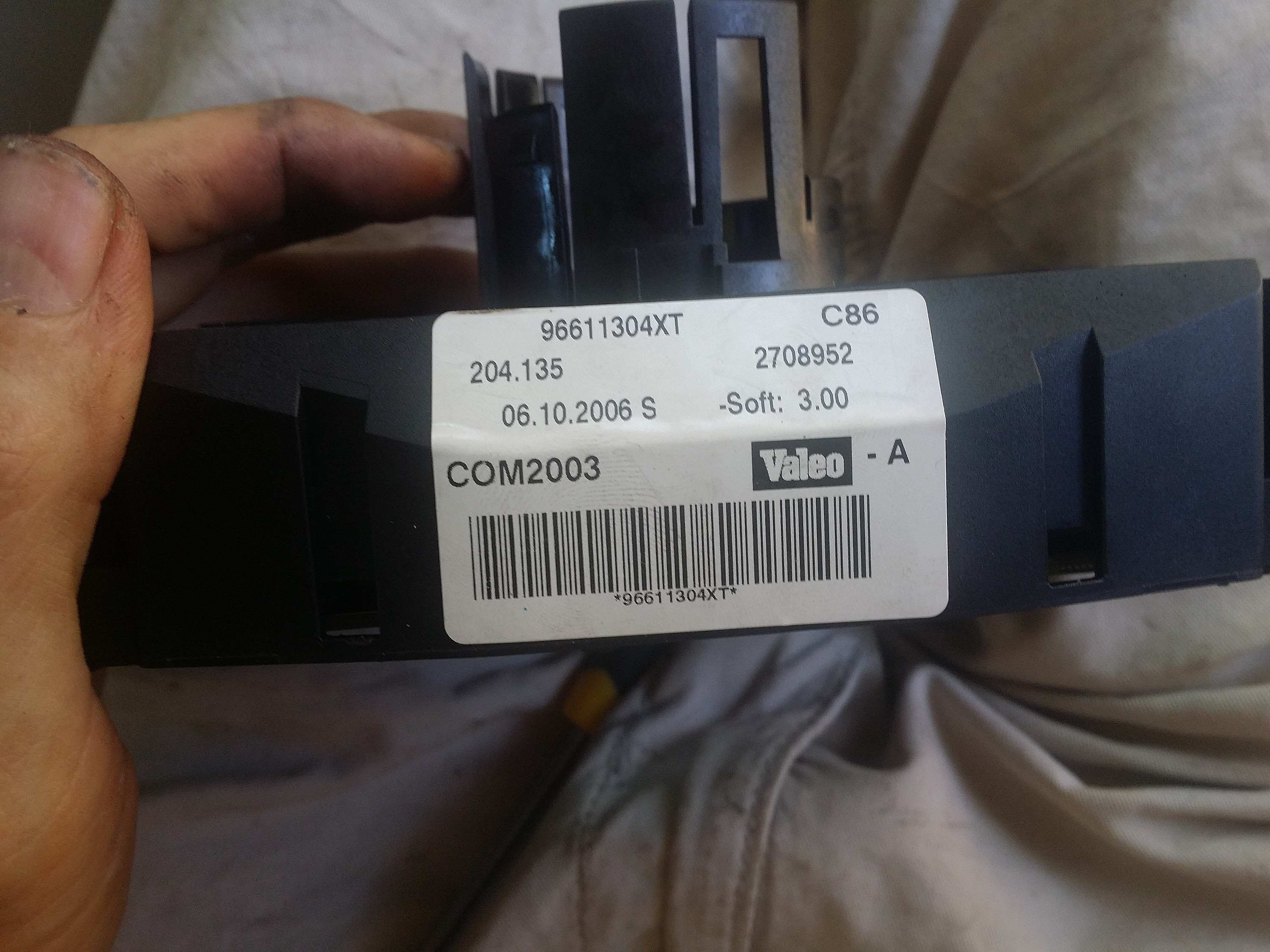

Serial Number 96611304XT
COM2003 Remove & Refit , Citroen C5 Steering Column Switch Module
COM2003 Teardown - Steering Column Switch Module

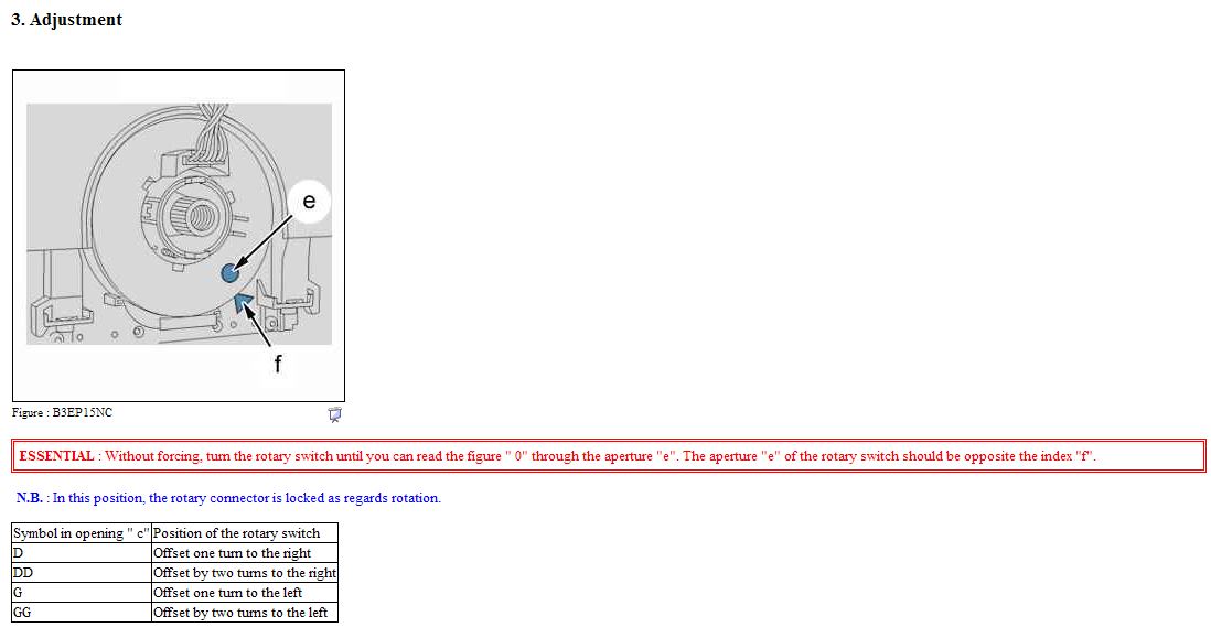

* After re-assembly make sure it can rotate atleast 2-3 turns each way from the center indicator to make sure you wont damage the ribbon.

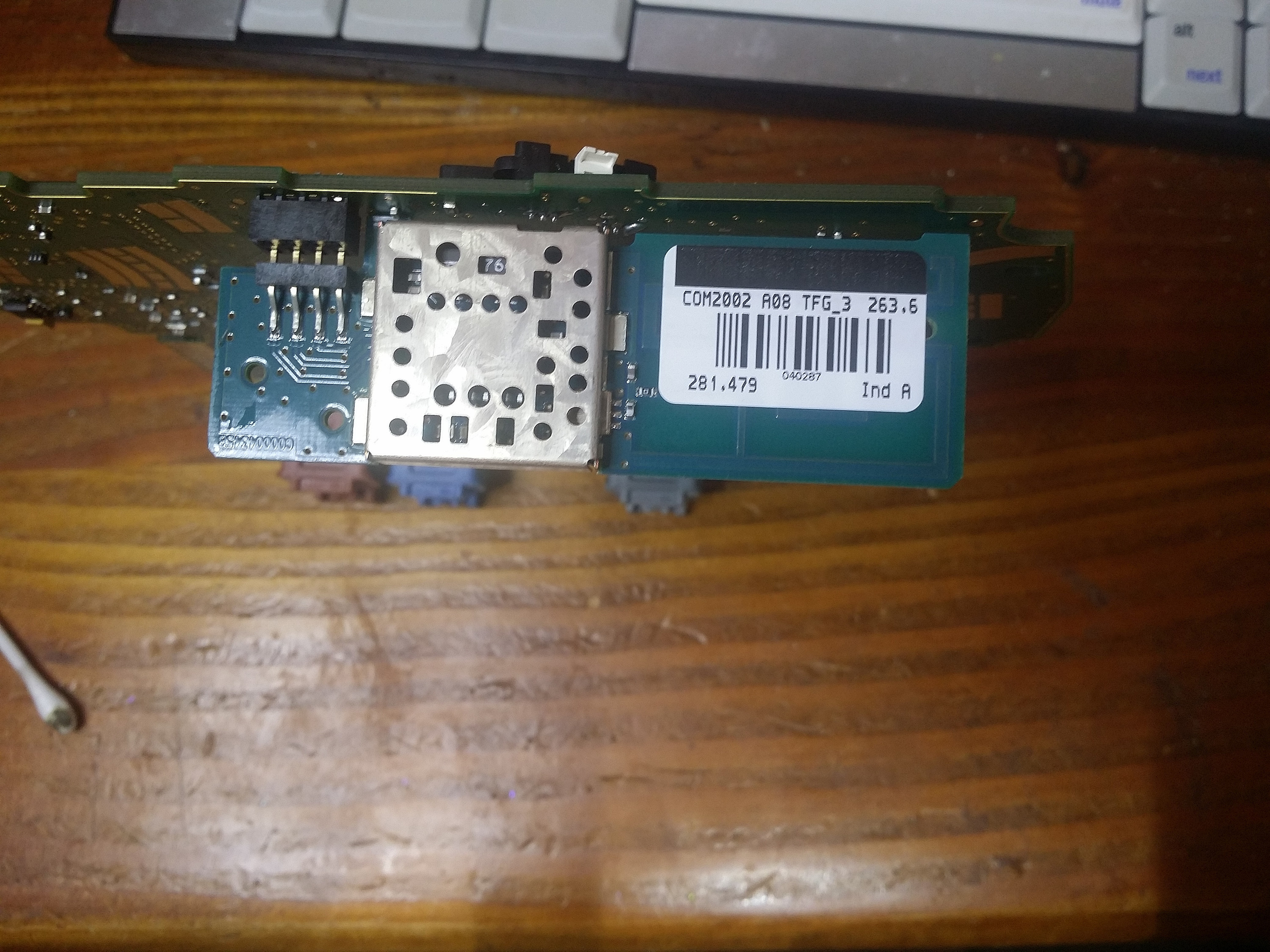

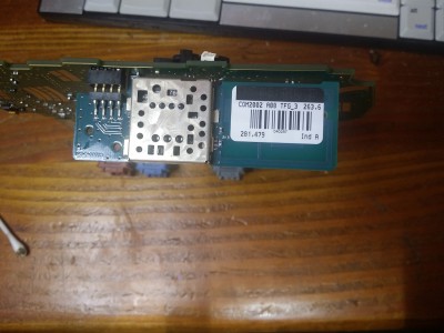

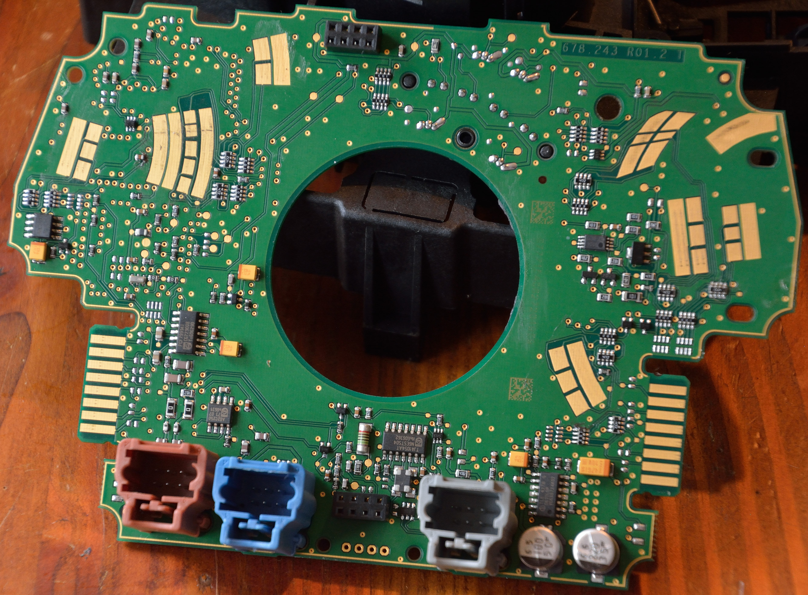

Rear of PCB, Showing all the pads the switch sticks work on, also at the top, is the socket for the Key RF receiver.
Front of PCB, showing hall effect magnetic sensors circled in white that determine the current wheel rotation number

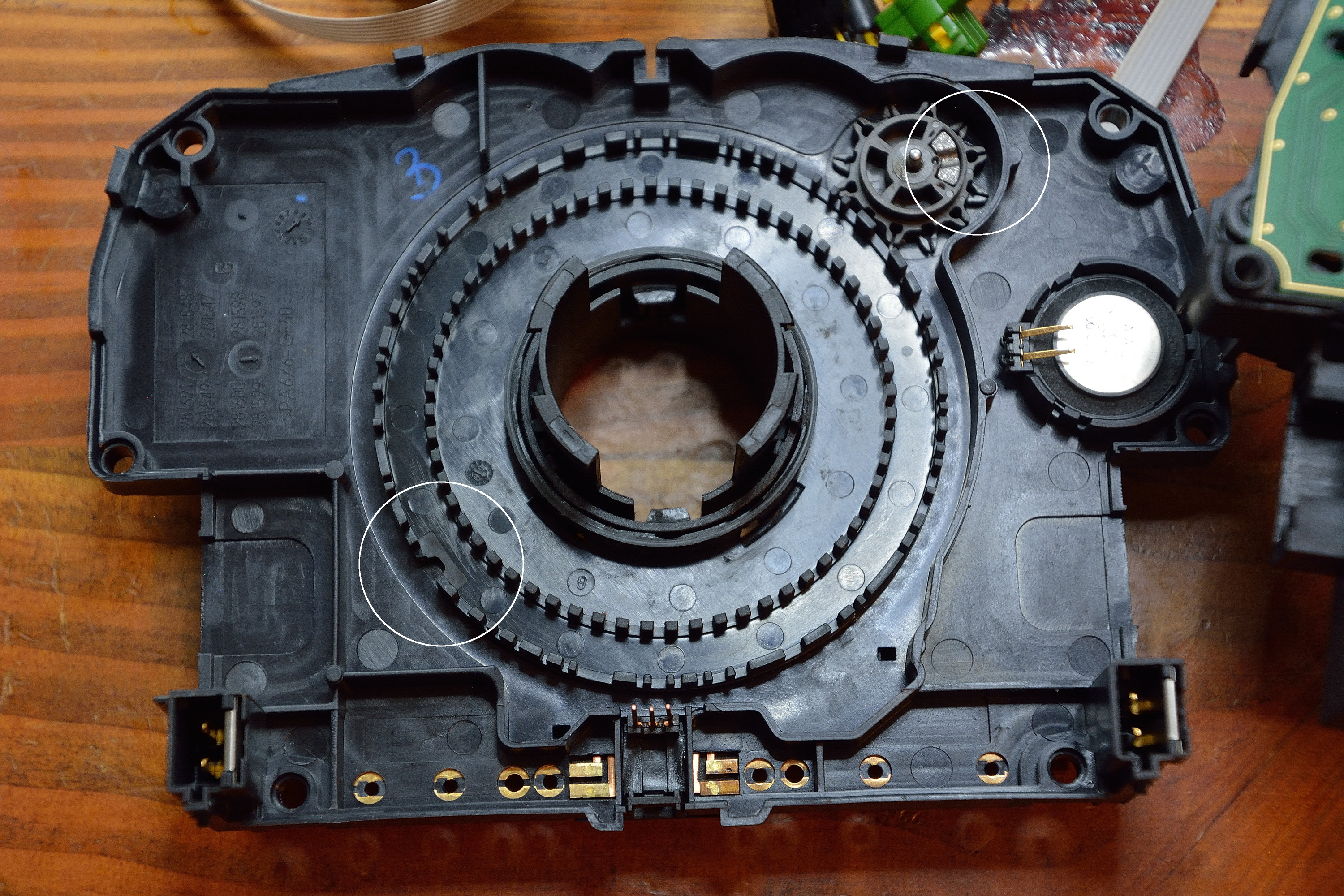

Circled in Red is the wheel angle sensors, looks like IR, with transmitter and receiver on opposite sides of the 2 tracks for the toothed rings to pass by, blocking or not in various patterns.
The 'toothed ring rotator', and the way i set it up before putting it back together, so in the wheel up right position, the magnet on the small cog, is over the middle magnetic sensor from the previous image. And the notch that rotates it on the big tooth ring, opposite it, so its half way between that position. (The clock spring can do 6 turns, 3 each way, but only 2 each way are displayed on the window letter codes when assembled (see last image), and then of that the wheel itself on my car can only do 1.5 turns each way.
Opposite side of toothed ring, inside clock spring, enter with care. The top circled, narrowest spline fits in the clock spring front plate such that is at the top of the steering wheel. Also note the circled lower right arrow used to indicate the orientation window, see video. There is a small cog that sits in the geared race, and drives the white clock spring reel.

From what i can tell the Key Fob RF Reciever.
The manual's notes on the alignment inspection window.

This is the live unit ! The reason i took it apart, is that we where getting intermittent errors relating to the angle sensor.
