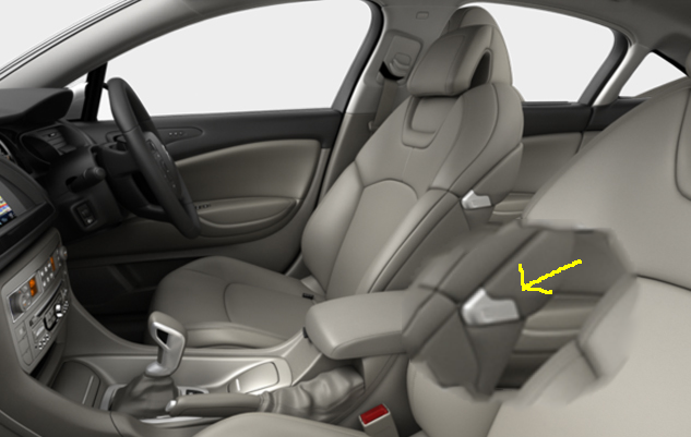

Ok, how's this for complete ridiculousness: £42 for a new LDS reservoir, but how about £56 for this little piece of chrome finish extracted and blown up - not more than 1 x 1½ inches!: I leaned over to the back seat and heard a 'pop' - and sure enough the plastic lug as gone walkabout. I can live with it - especially as I can buy the complete seat for £150 from a breakers (minus air bag)

Ahh....the joys of plastic
I think the boot "Nets" and the tiny plastic clips on the surround were supplied from the factory broken :)
