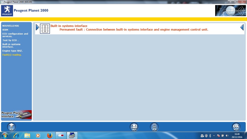

Hello ,
our 406 (hdi estate) was unused from February and was left with the battery disconnected.
When we tried to use it recently, the key symbol was lit.
Re-coded the keys , but symbol still lit.
Shows BSI Fault on PP2000 -
"Permanent fault - connection between built-in system interface and engine management control unit"
Will check connections on ECU and relay and report back , but any help and advice would be greatly appreciated.

No chattingi to injection ECU , no matter what we do - even on our crappy Lexia/PP2000. Key symbol still lit - all fuses good - all connections good - no sign of fluff or corrosion HELP.
Saw on another posting somewhere to check for 12v on wiring to ECU on one particular terminal and if absent cross with another 12v supply - but cannot find the posting now.....
No , not been flooded, no water in carpets.
We re-coded the keys with PP2000.

Its much easier to understand when you are looking at the diagram.
Pins 4 & 5 are joined internally & are outputs to the secondary side of the relay. 4 goes to the fuel pump & 5 goes to various auctuators & glow plug relay.
Pin 10 should be earthed by the injection ECU, when pin 10 is earthed by the ECU it activates the first side of the relay. this then outputs to pins 1, 2 & 9 which are joined internally. Pins 1 & 2 supply the injection ECU with 12v & pin 9 supplies the fuel pressure solenoid.
When pins 1,2 & 9 go live this also powers up the secondary side of the relay.
The secondary side of the relay is earthed by the ECU on pin 7 of the relay.
xsaras4ever
- Posts: 424
- Joined: 07 Aug 2013, 13:43
- x 44
Re: 406 Key Symbol - BSI Fault
Big thank you Wheeler, we think we understand.
We have no pin 5 , but thats apparently normal in some cases.
With none of the pins coming up to 12v at ignition , how is the relay activated - like you say - by earthing to the injection ECU ?
To test the relay, if we re-connect the relay and force-earth pin 7 and 10, should it activate ?
