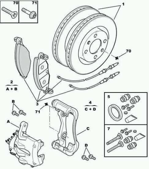

There are three separate things here, Calipers, Discs and Pads. These are for your 2.2 HDi Mk II C5 as per your VIN ending 139:
Disks (1 on diagram): 4249 H1
Caliper Cylinder (A on Diagram): 4400 L8 (Left), 4400 L9 (Right)
Caliper Yoke (C on diagram): 4404 60 (Left), 4404 61 (Right)
Pads (3 on Diagram): 4252 89 (The reference to the 4246 W2 part number was for the discs on my 2001 C5 SX 2.0 HDi which were 283 mm / 26mm in size that you asked if they were different - and they are).
