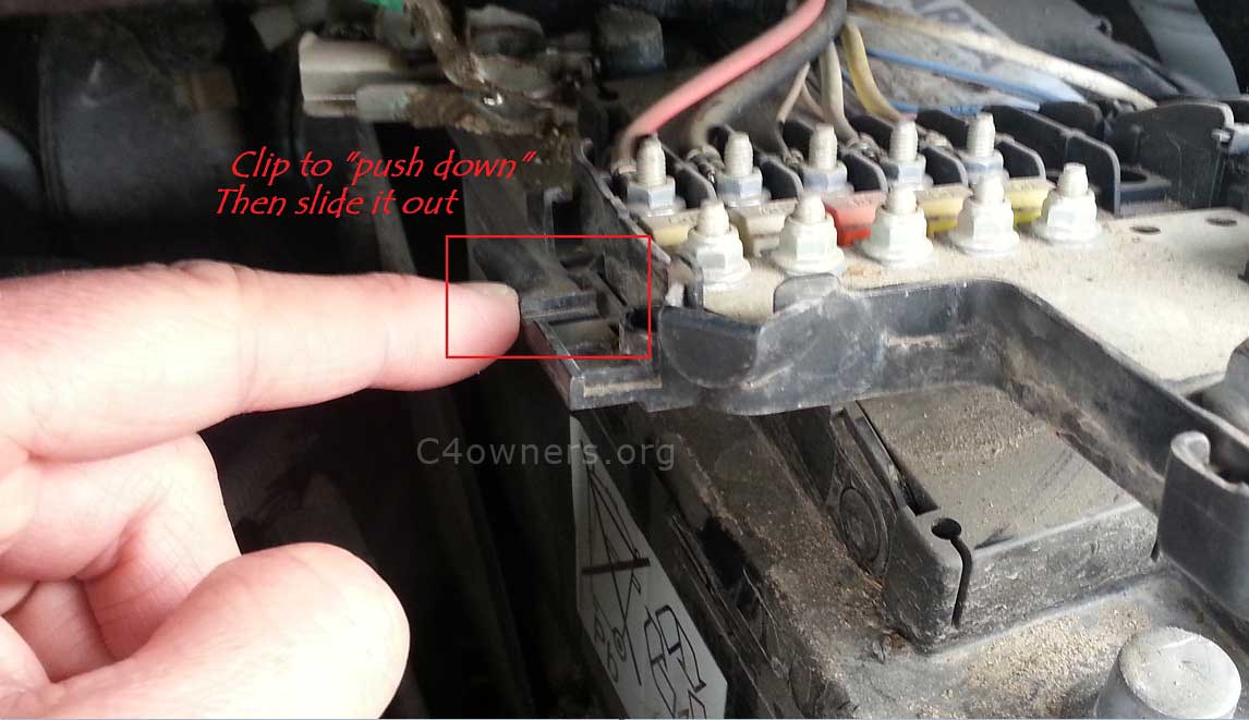

RichardW wrote: Buck - I think the relay is integral; there are 5 wires to the unit: power, earth, 2 command wires, and one from the BSI I am not sure of! Yes, there appear to be fuses under the plastic cover over the battery.
Thanks for that, will save me searching for a relay that it hasn't got :)
Looking at images of the C4 on google I see the bank of fuses you mention, they are normally clipped on top of the battery cover, this car doesn't have them in clipped on top so I'll take a look under the cover tomorrow.

Can't say I've ever noticed any fuses on top of the battery, the battery is under a plastic cover, are the fuses under the cover?
Any idea where the relay will be?

The fuse box is 'above' the battery in the sense that it is closer to the screen:
There is another fusebox under that one where the maxi-fuses are located. Thought I had a photo of that too but can't find it.

No, that's not it Steve - on the C4 there is actually a set of fuses right on top of the battery!

have that on the boxer I think... an odd flat box on the battery which is a terminal and some fuses.

I'm sure there are no fuses like that on top of the battery on our car, there is a normal plastic cover over the battery, so unless they are hidden under that?

Ok, looking at the car today, definitely no fuses on top of the battery like in Richards picture.
There is a fuse box next to the battery, this houses the ECU and also has standard and mini size fuses in it, there is also a row of maxi size fuses lower down but they are very difficult to get at, it looks like you would have to dismantle the fuse box to get to them. As far as I could see with my mirror and torch they all looked to be ok.
