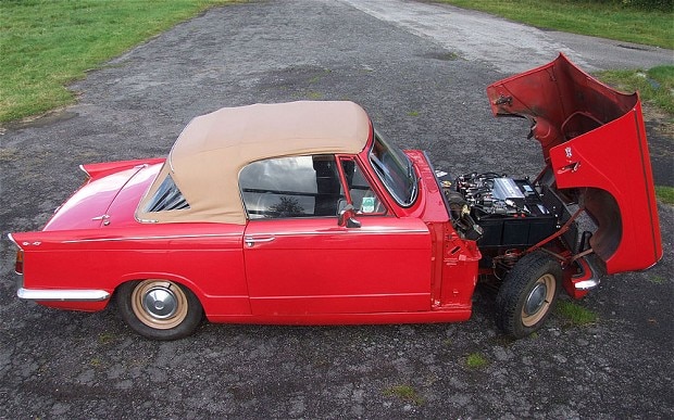

Another Triumph for the collection, the electric herald by DragonEV featured in a Telegraph article from 2013
http://www.telegraph.co.uk/motoring/gre ... power.html
THE FACTS Dragon Electric Herald
Netgain 25kW continuously rated motor, capable of 300kW peak power (about 400bhp)
Top speed: 75mph
Maximum range: 50 miles (up to 150 miles with lithium-ion batteries)
Clutch: none – direct drive to propshaft
Gearbox: none – sufficient torque from electric motor. Reverse provided by changing polarity
Ignition: none – just an on/off switch, press the pedal and go
Power output: 60bhp (capable of upgrade to over 200bhp)
Torque: 150lb ft approx
Battery voltage: 72v
Battery capacity: 15kWh
Controller output: 600A maximum

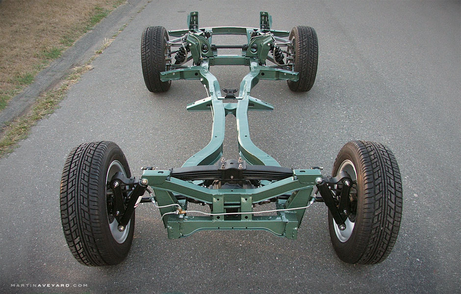

Could be that you can take the body off them and leave something like this as a basis to bolt the new motor and associated paraphernalia to :)
For me the end product is a desirable vehicle, the Spitfire more so than the Herald.

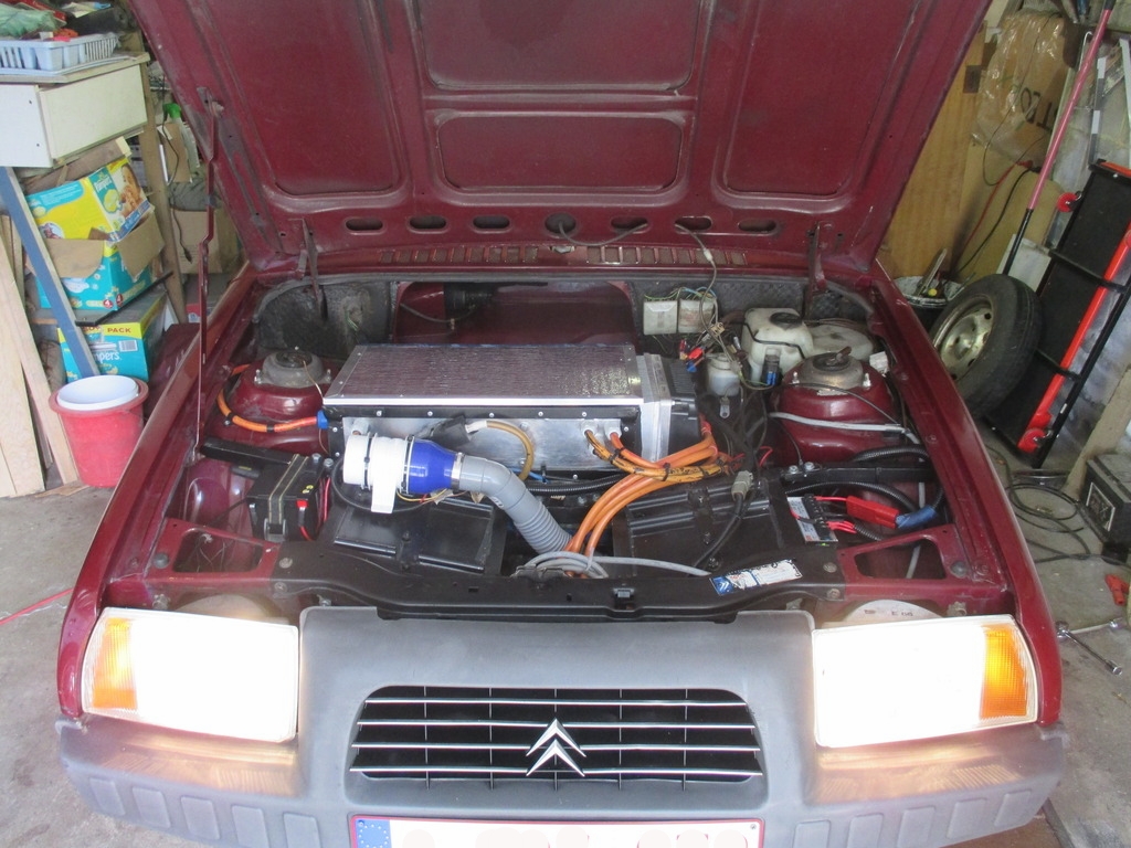

Just to add in a touch of French Car, I have just read through the D.I.Y. conversion tale of a Citroen Visa ( all 13 pages and 18 months of problem solving along the way, but at the finish the job was done, and much valuable knowledge and experience gained.
This link doesnt work surrounded by the normal with the ..... format for some reason. cut and paste it and it does....(the bit from www to html the dots are just to stop a link being automatically created)
.....www.diyelectriccar.com/forums/showthrea ... 06866.html.....
The end product
The car is a Citroën Visa with following spec’s:
Motor: AC-31, regen (very much) enabled
Gearbox: original Citroën 4 speed (1st gear unused)
Coupler: Made by local machine shop
Adaptor plate: DIY mc’Guyvered (didn’t go well at first, but worked splendidly afterwards).
Controller: Curtis 1238-6501 (fitted on thick diy heatsink, air-cooled, connects to AC motor with 70 mm2 cable)
Battery: 16 KWh from Opel Ampera/Chevrolet Volt; 4*96V modules in parallel (180Ah) interconnected with 50mm2 cable.
DC-DC converter: 500W (replaced 350w, which didn’t give enough juice at peak loads)
Small 14Ah back-up lead-acid deep cycle battery for 12V systems in case of system failures
Charger: 3kW TC-charger from evassemble.com
BMS: the wild version (none)
SOC meter: SOC meter

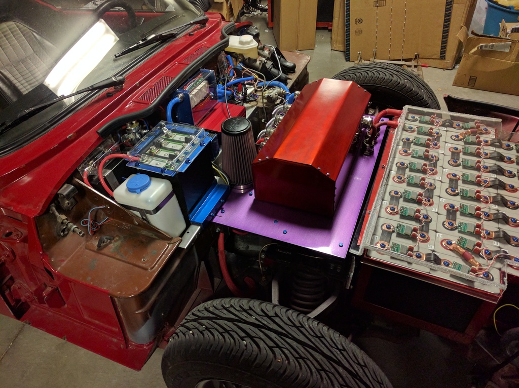

Still on the subject of Triumph Spitfire electric conversions there are at least 2 projects very well documented from start to finish on diyelectriccar.com.
Now wouldn't an electric Spitfire in Topaz Orange be a bit of fun for the summer :-D .

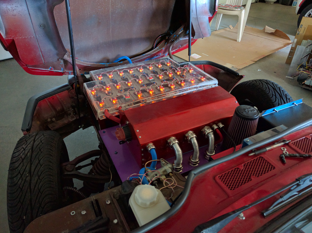

The underbonnet view of the electric installation of one of the Spitfire conversions-not unattractive...
especially when it lights up
