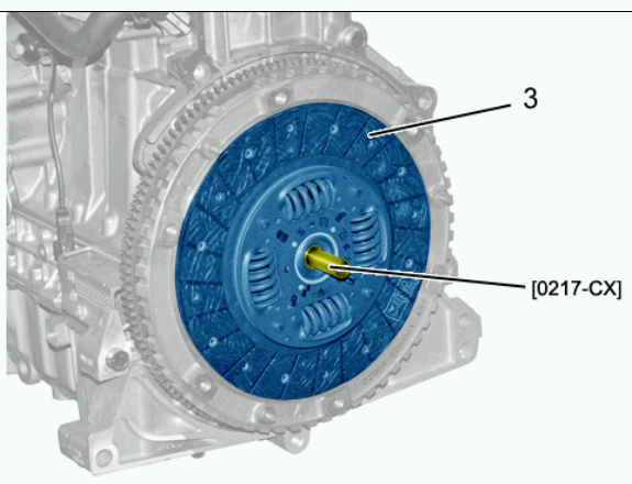

Picked up the clutch kit today, got home and have noticed that the clutch plate has no markings as to which side faces gearbox / engine. Its a Valeo kit and looking on their technical website there are no instructions for the kit at all. The similar kits (i.e for diesel models, not for petrol) do not give any advice either, just simple fitting instructions and torque settings.
The old clutch I took out, also Valeo, has no markings either !
The only stamps on the clutch plate are 'L' on one side and 'U' on the other. The clutch plate splines are longer on one side than the other, but I've never taken notice of this on other cars where I have changed a clutch as the 'gearbox' or 'engine' facing side is always clearly marked.
I was hoping to put it back together tomorrow.
Any ideas people.
x 6956
Re: C8 gearbox / clutch advice please
Here's the diagram for your car - not sure if this helps, they say underneath "Caution: When refitting, place the face of the clutch disc, where the No PSA ******80 is marked, gearbox end".
I know you have a Valeo, but maybe the pic will help. What about the markings on the plate (the grooves) from the picture they seem to angle to the right.
Unread post by ozfish1969 »
Marc,
Thanks for that, a great help.
I did email the Valeo technical department for advice but they closed at 17.30 so still waiting.
The picture makes it crystal clear now, as the plate is quite distinctive on one side to the other. Its going to be the side with the longer shaft towards the engine, and the stamped 'Made in France' towards the gearbox.
Other than 'Made in France' and a serial number, my plate has no other markings. I even checked its validity on the Valeo site as there are copies out there, though I did buy it from GSF so would expect it to be genuine.
Why they can't simply stamp engine or gearbox on the plate, or even a 'E' and 'G' is beyond me.
Thanks again.
x 6956
No worries, just happened to have the service docs opened and saw your VIN, so only a couple of minutes to snapshot and post. I know it can be frustrating to hang about - especially now they have closed for the day!

Now I'm confused !
Found some instructions online for clutch replacement on a Peugeot 407 which states the plate fits the other way around than above. Wish I never looked now.
My kit also fits a 407, among other French cars, and as we know a lot of the engines and gearboxes were shared between the manufacturers.
The picture above sent by Marc certainly looks right in so much as the visible clutch plate is identical to the one in my kit so with that in mind I will fit is as such.

Just realised the 407 is a 'pull' type clutch not a 'push' type as is in my C8.
As such, I am thinking, a 407 pull clutch is actuated sort of back to front hence the clutch plate being installed the opposite way to Marc's diagram for the C8.
Unread post by RichardW »
Offer it up to the flywheel - it will probably only fit one way round - at a first pass I would fit it with the more domed side towards the gearbox.
