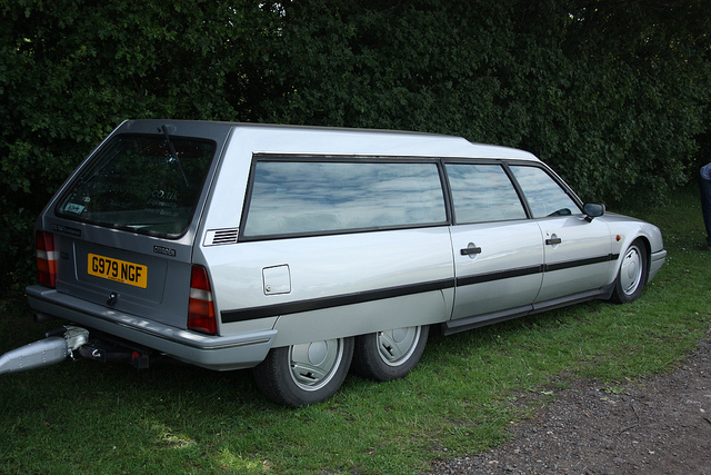

CitroJim wrote:
Hell Razor5543 wrote: Does anybody know where there might be a breeding pair?
Chris570's and mine - almost identical....
Unfortunately Jim, that is not a breeding pair, as there is nowhere for the Xantia foetus to develop until it is born. You need one of yours and an Activa one of these for a breeding pair;

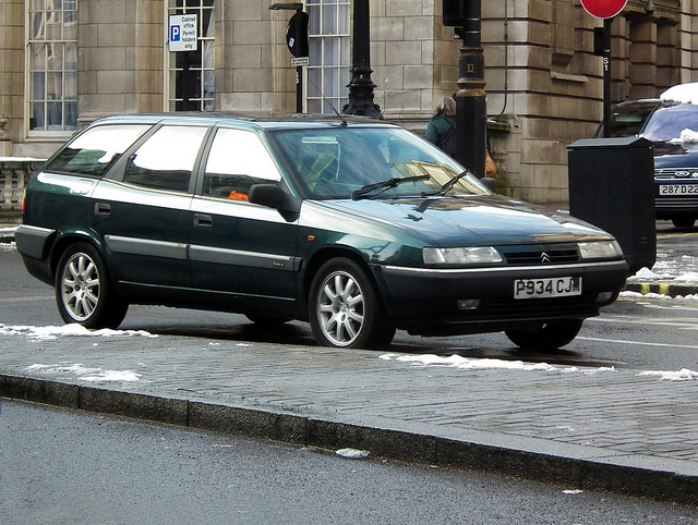

If you could get your Activa to breed with one of these the DNA might throw up an interesting mix (should not have the inbreeding issue), and there is enough room for twins (or, with luck, triplets!);

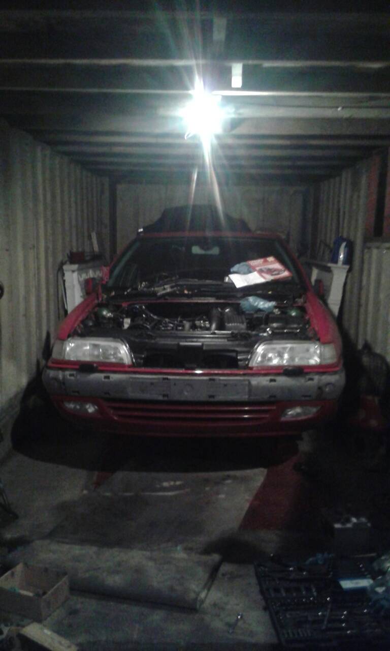

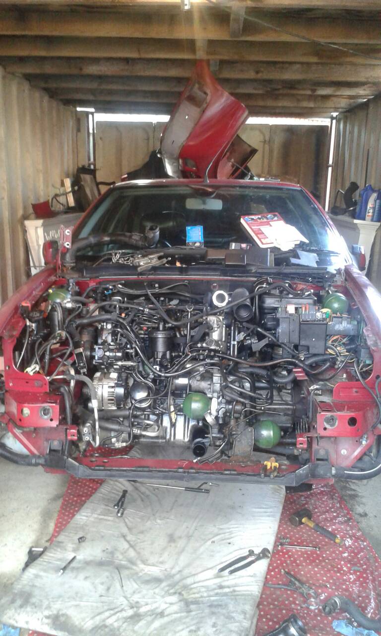

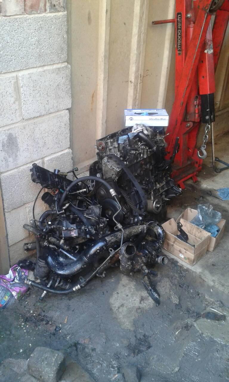

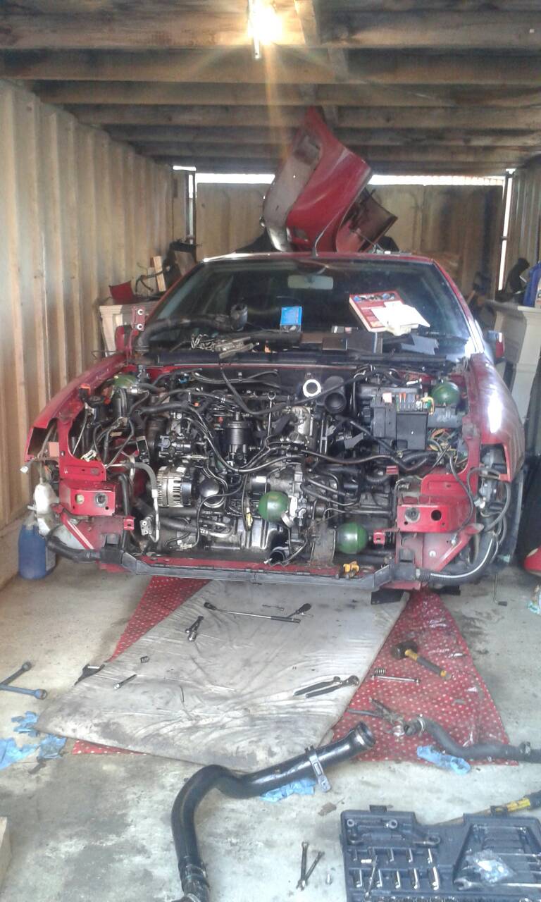

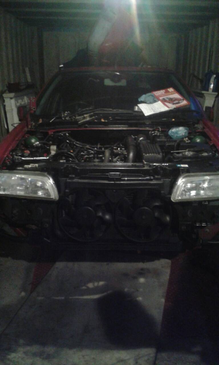

Just some pictures of the new arrival almost all ready for the road. ImageImageImageImageImage

The last picture is of spares that came off the donor engine. I will sort these out and probably post on here in the new year. Not sure what car the engine came out of but we had to change everything off it as everything was different. Correct engine code but everything was smaller.

Engine in and running. Just flushing through to do. Is there a special way to bleed up the coolant system on the hdi 110.

Excellent :D No special way to bleed as far as I remember but do be aware that if an auxiliary heater is fitted, either the glowplug variety or the Erberspacher, they must be confirmed full of coolant before first start by bleeding the heater matrix circuit...
The glowplug type in particular can suffer irreversible damage if run dry.
