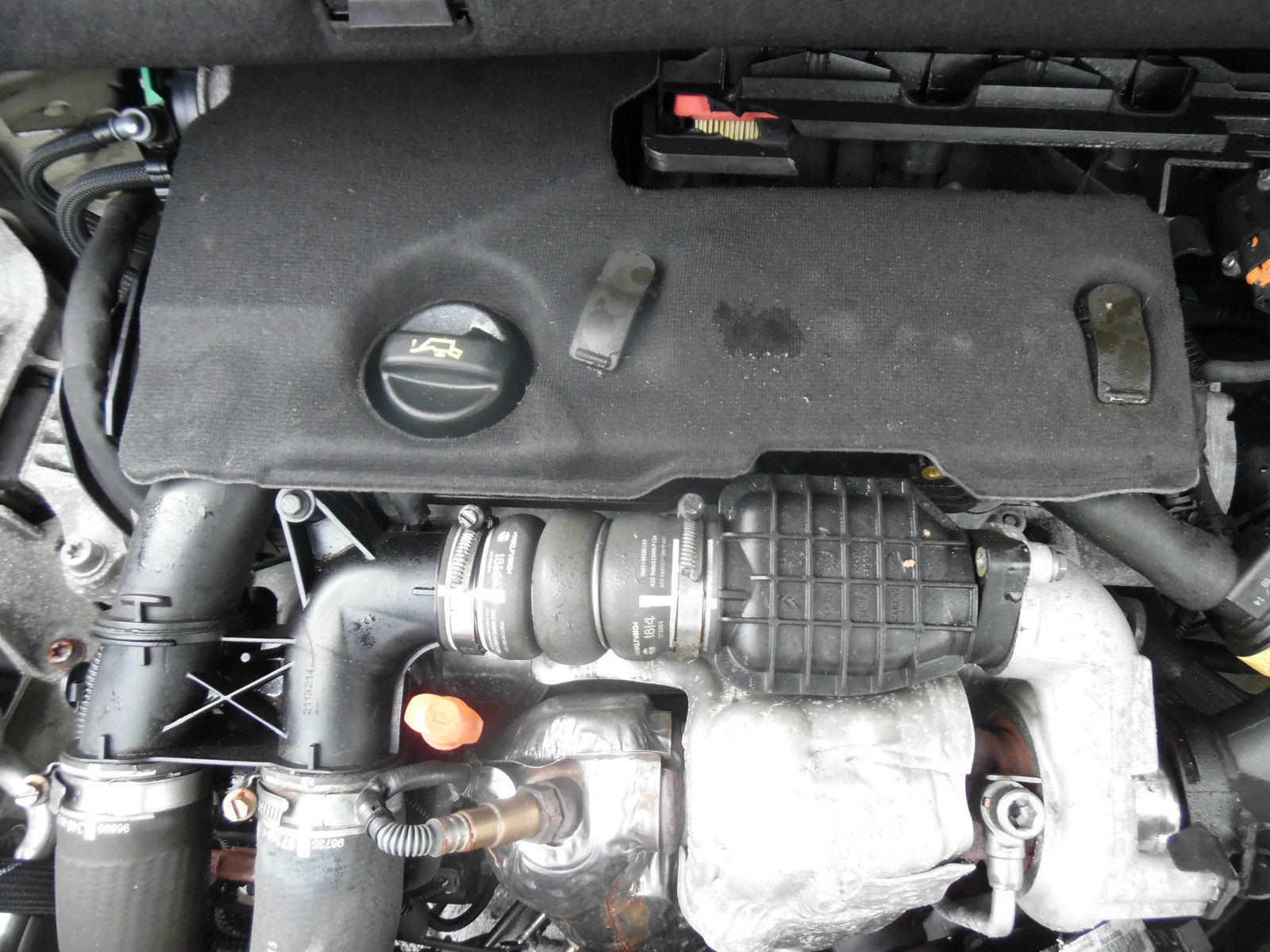

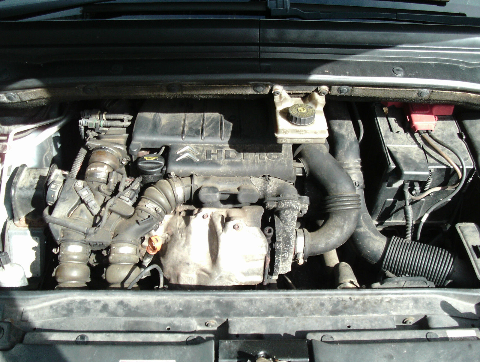

16V engine:Old-Guy wrote:How does one immediately tell a 2011 reg that has the earlier engine (I once salvaged parts from a Xantia built in late '95 but not registered for some 9 months!)?
Note plastic cover and tubular turbo outlet
8V engine:
Felt cover and square ribbed turbo outlet.
The 8V engine has a lower CO2 rating, takes the tax down from £175 or so to £130.
Like I say, they went back to an 8V unit in 2011 which is much less problem than the earlier engine. Having said that, my parent's one needed a new injector at 45k!!Old-Guy wrote:Is the popular 16V 1.6HDi post 2010 troublesome?

Richard,
Thanks very much - all crystal clear now! A picture's worth a thousand words.
Just been having another look at what's on Autoraider: quite a number of 2011 1.6HDi 16V VTR+s advertised - most without engine pix, one that does shows an 8V!
UPDATE: Having talked to the private seller of one of the above, an explanation emerges. The car was ordered as a Grand Picasso 1.6HDi 16V VTR+ in May 2010. The car was eventually registered/delivered (in February 2011!) with paperwork stating 1.6HDi 16V, but with emissions and tax class at the lower figures of an 8V! A photo taken today is definitely of the same external engine configuration as Richards second photo above. So it appears that Citroen held up orders for RHD Grand Picassos for some months in 2010, before releasing them for build to 2011 spec with 8V engines. Unfortunately, I don't have a VIN for any of these cars to see what service.citroen shows.
