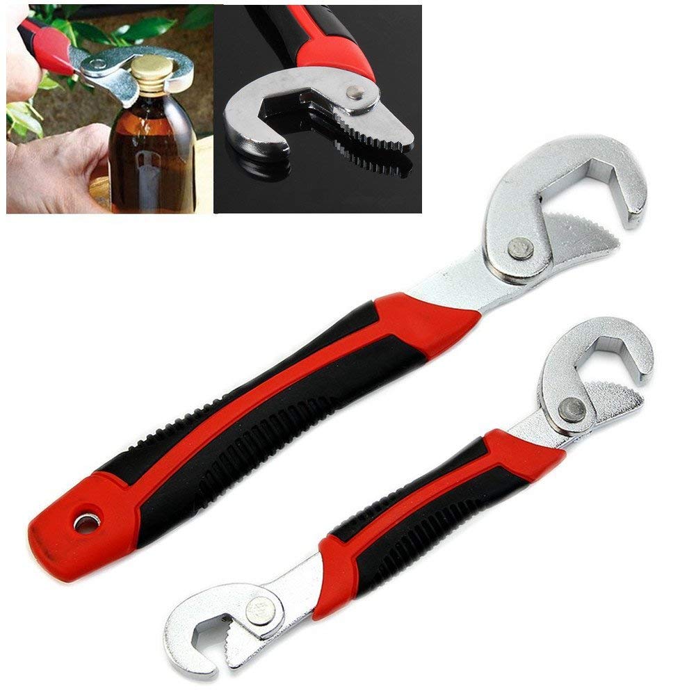

Would these or something similar be able to shift it - perhaps file a couple of flats on it if there is access for a file?
James Hellrazer reports a fair amount of success using them (not necessarily this make).
