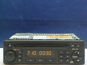

Agree. We need to see what you have really.wheeler wrote:What radio do you have
The 'factory' one at that age is typically something like this:
Could be radio / cd or radio / tape obviously.
The 'surround' (complete with curious pen holder space) comes off its not part of the radio itself. Not shown in that pic.

Oldpug
- Posts: 561
- Joined: 07 Aug 2010, 11:15
- x 94
Re: 106 zest 2 1.5D - cannot read engine ECU
I used to give the serial number and model details (found on the back of the radio) and the car vin number to my local Peugeot Dealer and they would come up with a code, for a fee of course,£20 - £25 ?
Plenty of places online will do the same.

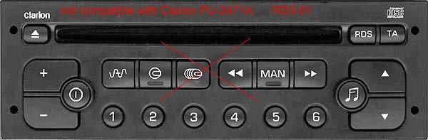

That's a 206 or Citroen one without display. It will not work in a 106 (well not very well) as there's no display panel.Harlequin wrote:
it looks like that
The one you have *is* VIN coded yes but its not going to work in a 106.

That type (without a display) does not have a 'code to enter' as such from what I recall. The 'coding' when you fit these (to a multiplexed car with a separate display only) is done via the diag to just tell the BSi you have a 'new' radio. It does actually work without this coding but it bleeps (loudly) constantly via the speakers, as an 'anti theft' thing.Pug_XUD_KeenAmateur wrote:I do have one in my loft if anyone can use it, given to me by someone I trust whom I'm confident wouldn't've bothered if it wasn't in GWO. Don't know the code thoughmyglaren wrote:Offer it here, may be of some use to someone.
Having said that, you can hear the radio / cd / tape etc well enough to at least confirm its working correctly or not, but its not 'useable' as such until its coded. This is a bit like the 'test mode' you can do on some Clarion (possibly others) where you can make it work without the code for about 10 minutes, it does not save any station presets (on purpose) if you do this and it can also bleep about once every 30-60 seconds too but again its "alive enough" to determine if its a working unit or not.
